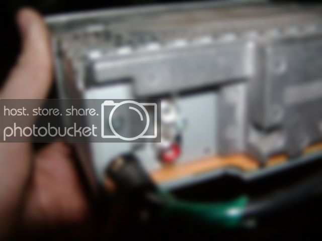

i have a pioneer deh1500 head unit and just bought a xplod 4 channell amp 600w ( i know its not the greatest and wont last realy long but if it does il take it back to walmart).... i figured out how to connect it to the battery and all of that but idkhow th connect the head unit to it... the amp has two places to plug in the out put from the hu but my hu only has one out put so wat do i need to do? also there is a remote output next to the 12v in put that is supose to go the the hu where does that go? thanx im new to this stuff so any help would be good

i found on the head unet a wire that says system remote control. do i need to splice into that for the remote out put to the amp
yea, the remote wire on the HU (blue with white stripe) will go to the remote on amp. as for the rca's check on the amp, it should have a setting to send the signal to all four channels with just 1 set of rca's. if it has it it might show {2,3,4 speakers}
i dont see any switch.............. in the 2nd pic u can see where the terminals on the right say L+R so would that be both to all 4 channels
