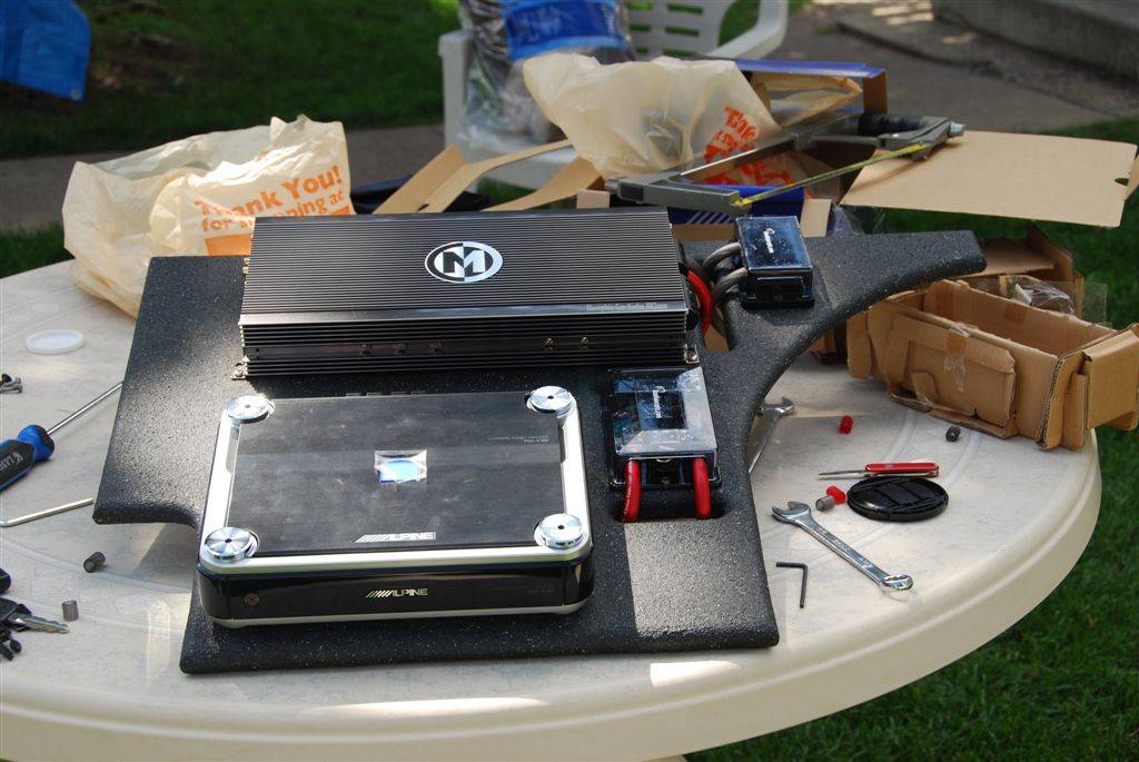

I went to a local car installer and we came to this conclusion. The sub amp is radiating EMI into my RCA's (he tells me digital amps are noisy). I had the excess length of RCA coiled up under my amp board right underneath the sub amp. So I took the back seats out and everything out and rerouted the cable so that they are as far away from the sub amp as possible and coiled the excess cable behind the back seat. The noise isn't completely gone but it has lessened... I think. the true test will be with my GF in the car.

Thoughts? Anything else I can do? The 4 channel amps is close to the sub amp so the end of the RCA's is still 2" away from the sub amp.

My problem now doesn't seem to be a ground loop issue but more a EFI into RCA issue coming from the sub amp. Which makes sense because I couldn't understand how I could possibly have a ground loop issue with everything powered and grounded at the trunk battery. Where is the potential for loop?
Well the noise was significantly reduced after I rerouted the RCA's away from my amp board and put the excess wire behind the back seat instead of underneath the amps. Last night I had the stereo on the entire time and my GF didn't complain once about the whine. So for the time being I am going to accept the results. The noise is still there, which still bugs me that it is but at least I can't notice it now while driving.

I don't think it is a ground loop issue I am experiencing. I believe it is RFI from the sub amp.
