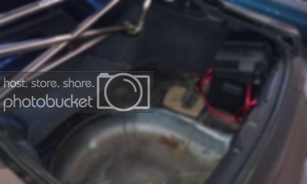

my back seats will be removed and have my batterys and amps there.
so the spare battery casing in the back will be moved.
and the spare tire compartment, would that just be better to make a false floor and not even try to use that space?

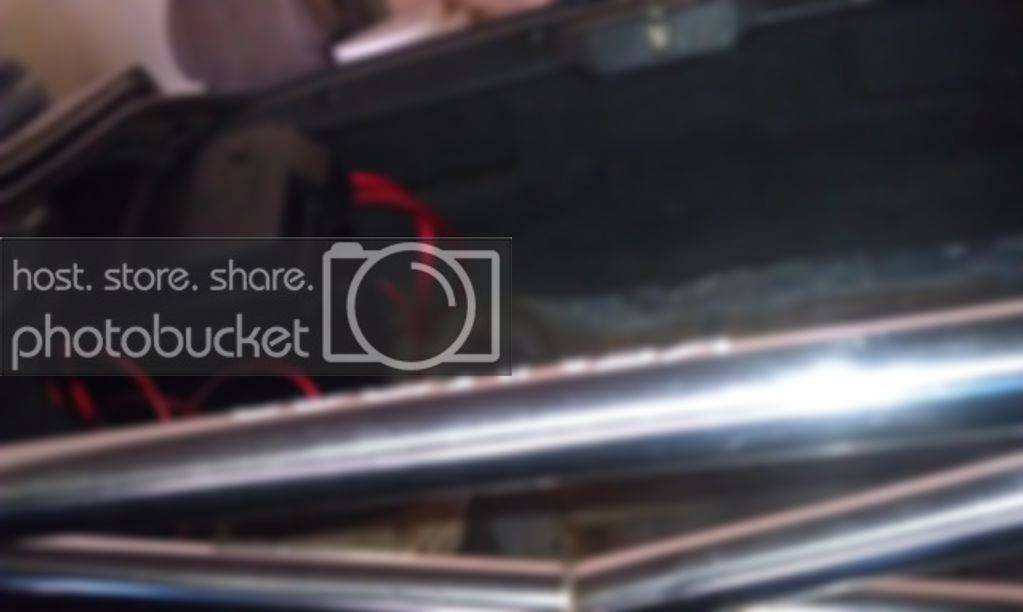

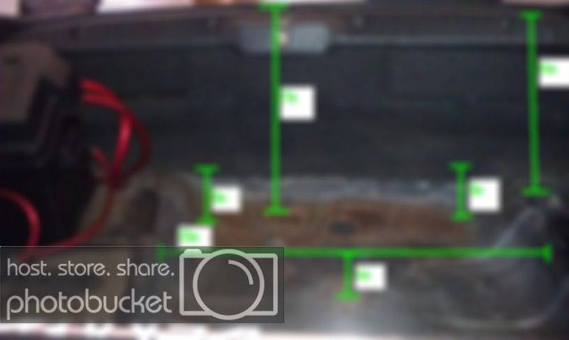

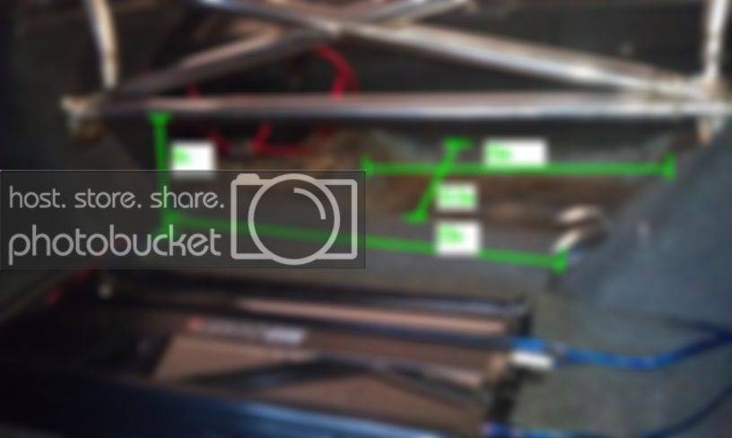

heres pix of what im working with
View attachment 26529951View attachment 26529950View attachment 26529954View attachment 26529955View attachment 26529956View attachment 26529953View attachment 26529952View attachment 26529957

I have a friend that's a DC dealer and I do believe Rusty @ DC told him that 1.5 cubes net per sub (12" level 4) was perfect....I don't remember if he recommended a specific tuning but 33-35 would more than likely work just fine. As far as the box design maybe do subs up, port back or subs back port back......The second combo was louder in the civic hatch we done a while back......Some hatch cars work nicely with Aeroports......not sure........I am sure you will get more comments and ideas just hang out a while.......A lot of builders/designers on here

ya the battery in the back will be moved to the rear seat area (with rear seat being taken out)
and the sway bars i was wanting to keep them in.

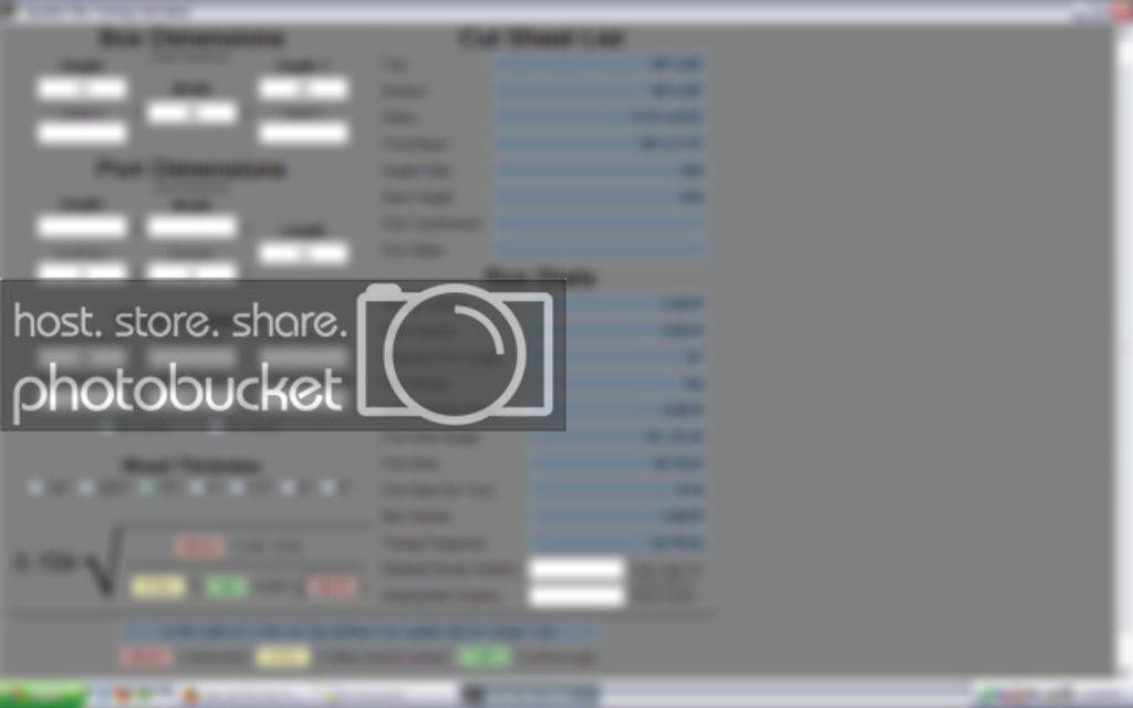

im trying to learn the sub box enclosure calculating software on the computer to help me out (but learning as i go along)

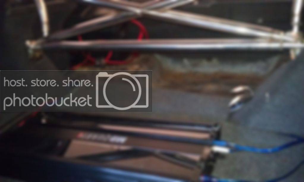

You can set that amp(onyx up on its side) with a bracket to retrieve approx 10 in more space also, and put the battery on the far rt side at the rear.A Kinetick 600,0r 800 will fit great in there.That amp will run cooler up on its side also, and prob wont need a fan to keep it running cool.Just a few suggestions.I will say this..That was the hardest wiring of any vehicle i have ever done.It took me 2 days, and evrything was a pain in the A##, but it was worth the trouble after done.//content.invisioncic.com/y282845/emoticons/biggrin.gif.d71a5d36fcbab170f2364c9f2e3946cb.gif

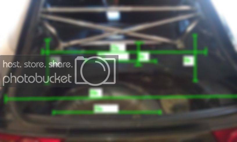

but im having trouble trying to calculate the volume of my "imaginary box" becuz the front plate will be smaller than the back plate on the box im thinking of. (idk if anyone can understand what i am trying to say here..)
i kno volume=LxHxW but each LxHxW of each plate is different..

L x W x H= sum devided by 1728=cu ft. I had mine firing up towards the back glass to reflect towards the front.Sounded Great.Cant help you there.Im only good with true square measurements,Easier to do.Have you asked Pro rabbit or Ram or any other sub box builder?, or ran a thread on the Help 101 on enclosures yet?You may get a better response there?

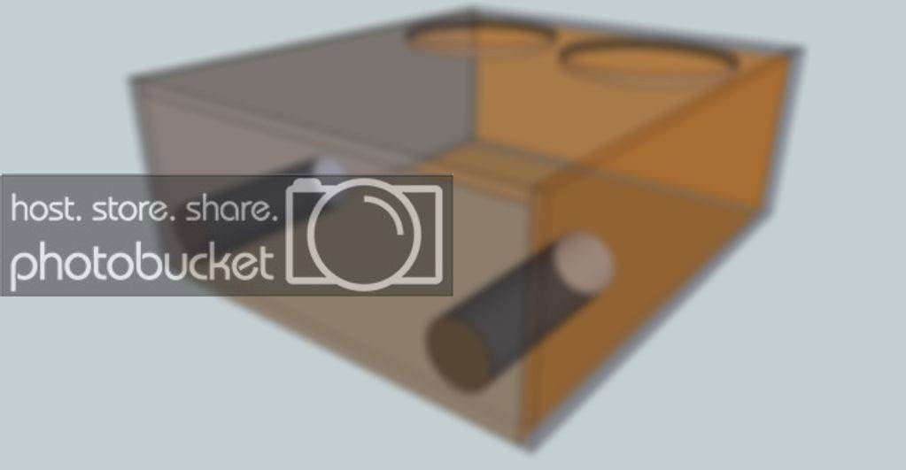

im wanting to be tuned to 34 hz
would i be better of doing a
(my min. dimensions) 4.46cubic feet box with port sticking outta the box
or
(my max. dimensions) 6.685cubic feet box with port inside the box
For a pair of 12s with 2600 watts on them i HIGHLY recommend increasing the vent surface area by quite a bit. I would recommend dual 6 inch aeroports at minimum. This would give you about 56 sq inches of port (14.36 sq inches per cubic foot)...as opposed to the 25 sq inches of port you currently have (6.44 sq inches per cubic foot)...assuming a Vb of 3.9 cubic feet that is.
