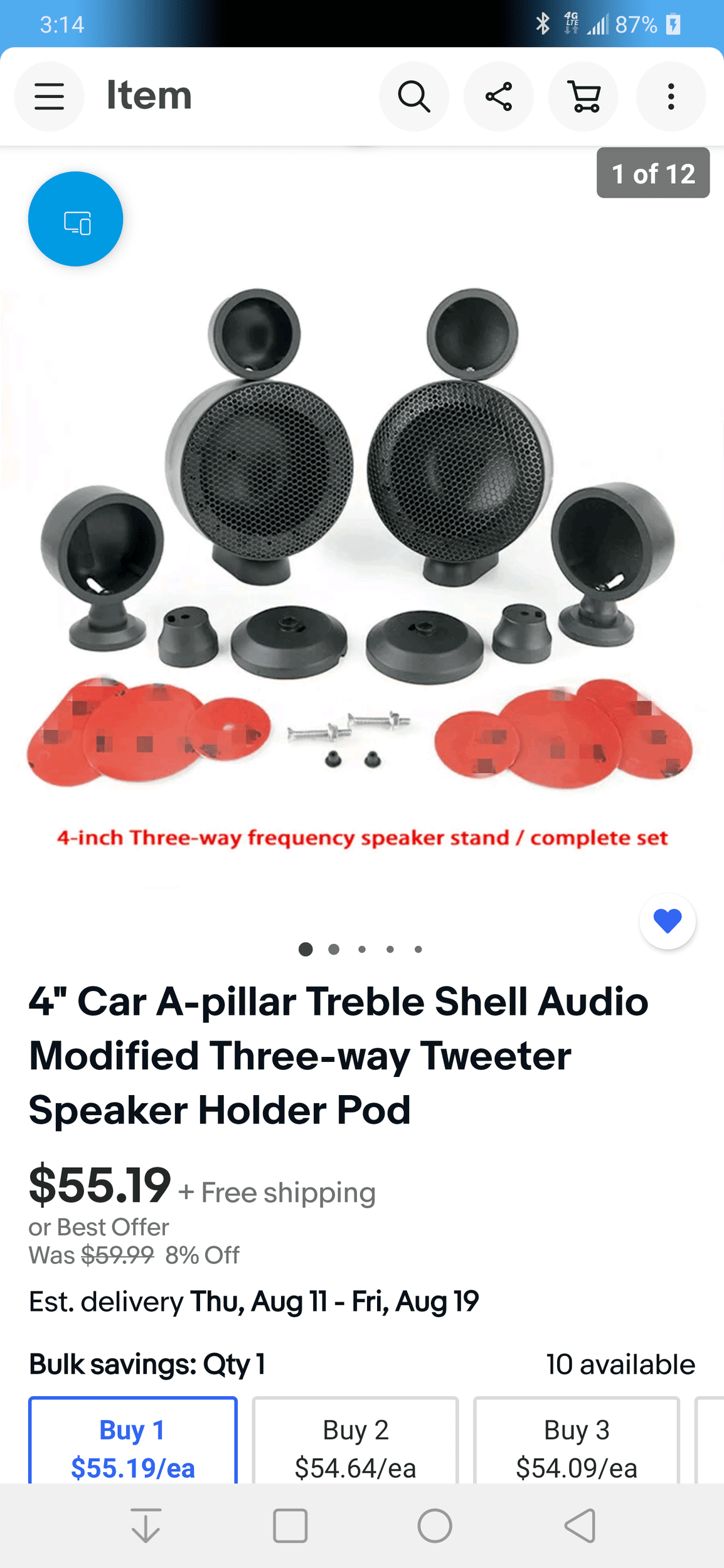

Take a Dremel/file/sanding drum to those pods from ebay. You only need another 3mm to fit your speakers.
If you're determined to put them in the door, then I'd do #2 if you're sure it won't interfere with the door mechanism.
If you really want to keep pace with your 6k subwoofer system, I'd suggest horns (expensive car audio specific one - I think Eric Stevens is still making them on Facebook or USD from speaker works) or just something off the shelf. You'll want a high sensitivity/FS pro-audio style mid bass driver - the bigger the better, ported if possible.
Thanks. So I found a set of pods online that should work. Either in the kick or the dash but I'll see when they get here. They're made by select Increments.
They'll for sure fit on the kick panel but if I can place them on the dash then I'll go with that.
