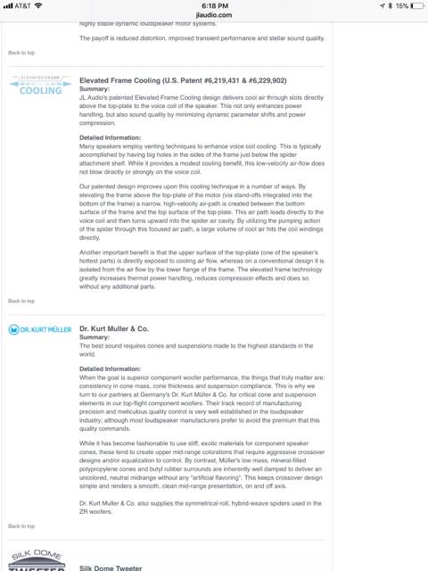

I tend to believe JL Audio backs up the complicated scientific principals when it comes to the higher end products.
