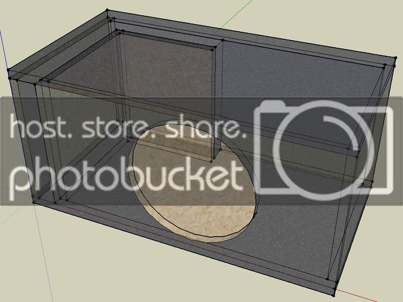

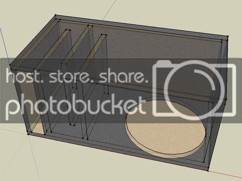

Hey guys it's me again Ive come up with 2 designs, 2Cu Ft. tuned to 32 Hz. But the catch is the port is only 1.75" by 12",
Or 1.569 Cu Ft. Tuned to 31.09Hz This has a larger port at 2.25x12"
Please let me know which would be louder and go lower.
