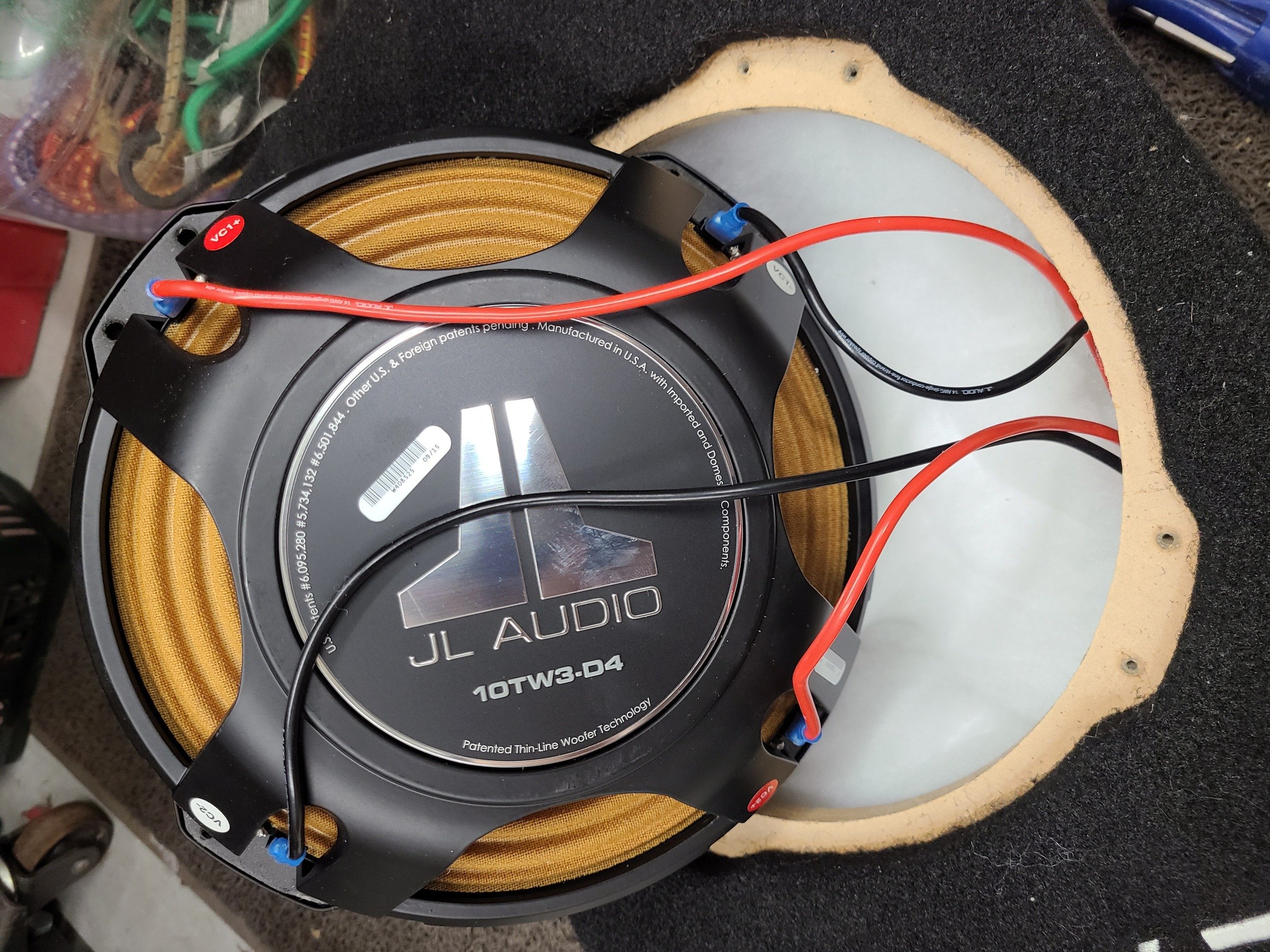

I appreciate all the advice you guys have given me.also trying to help me figure this out. I just had a wrench thrown in to my whole situation with my sub amp in my truck. I purchased my Son a 10" sub woffer and amp for his car for his birthday. He told me that hes not really in to stereo systems like I am. So here's the deal. I have a brand new JL10TW3 - D4 dual voice coil and a new Kenwood X 500 - 1, 1000 W, 300 W times 4. Or I have my brand new kicker comp 12" DVC with my new 300.1 kicker mono and. What would be some of your suggestions on how I should run these Amps and speakers? Thx in advance.
That JL is perfect for your Kicker amp. That sub can be wired to 2ohms, and it is designed for a tiny box. On a sealed it only needs .5 cubic foot, and .6 cubic foot ported at 42hz. I did not understand what your Kenwood amp is/are. Would you post a model number? Btw, that JL sub, niice.
The app model number is X 500 -1. The JL Audio sub has one voice coil positive is ran to the positive side of the plug in for the wire off the amp the second voice coil wire is ran to the same plug in coming off that amp. The negative voice coil one is running to the plug-in built inside of the box for the negative terminal voice coil 2 negative runs to that same terminal at this time..

The app model number is X 500 -1. The JL Audio sub is B 1 voice coil positive is ran to the positive side of the plug in for the wire off the amp the second voice coil wire is ran to the same plug in coming off that amp. The negative voice coil one is running to the plug-in built inside of the box for the negative terminal voice coil 2 negative runs to that same terminal at this time..
Just saw the specs on the Kenwood. It is perfect for the JL, 500wx1 @2ohms. From your reply it sounds like the JL is already in a box. If that is so, then yes. The sub positives go together then to the positive of the amp. Now the negatives go together, then to the negative of the amp.
