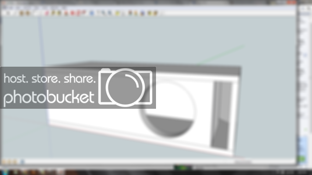

My SA-8 is on the way, D4, V1.
I'm planning on giving it around 8-900W daily.
I'm assuming the best area would be .6ft^3.
I've been trying to come up with a box design, but I'm not getting anything that will work for me.
Looking for it to be tuned to 33hz. My only dimension constraint is 10" high.
Can anyone help me find the width and depth, along with the port length and width for an 8.5" high slot port?

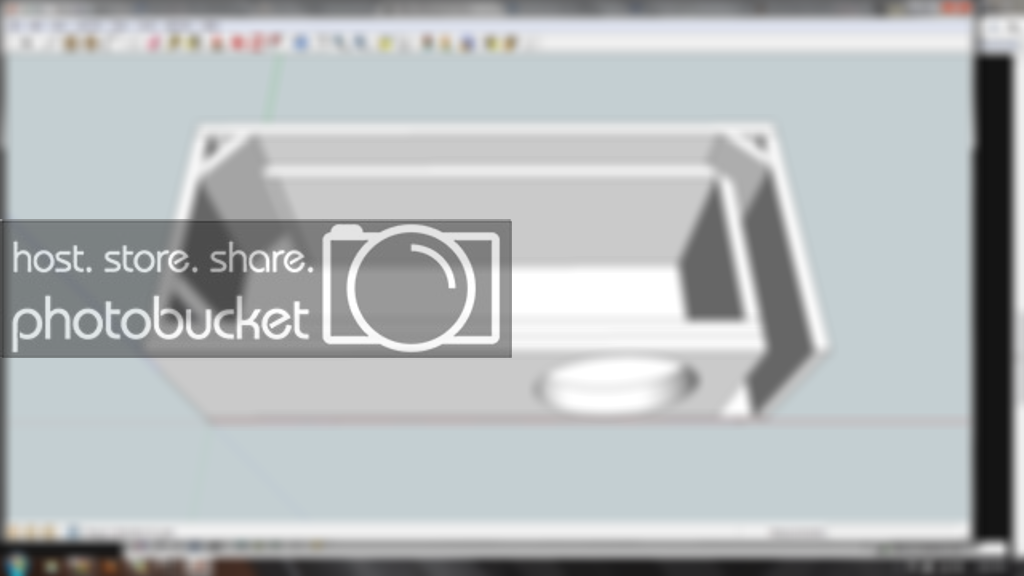

Here is 1cuft tuned to 33Hz
10"H x 30"w x 12.25" (13" actual depth due to double baffle)
8.5" tall port 2" wide 36.5" long
Someone might come up with something better, but this was my go at it.
I have a enclosure in the works for a pair at 1.12 after displacement tuned around 36hz though. Tuning is a pain due to how small the enclosure is.
Truth. That's why I said it was too large. 1cf and 900 watts daily that poor sa8 would hate you.
Why yes it would.
I have mine on 1k~ish each (never measured, but amp is 3K at 1, and Im running at .67) in .6 and have only heard them bottom once or twice. lol. Terrible sound..
