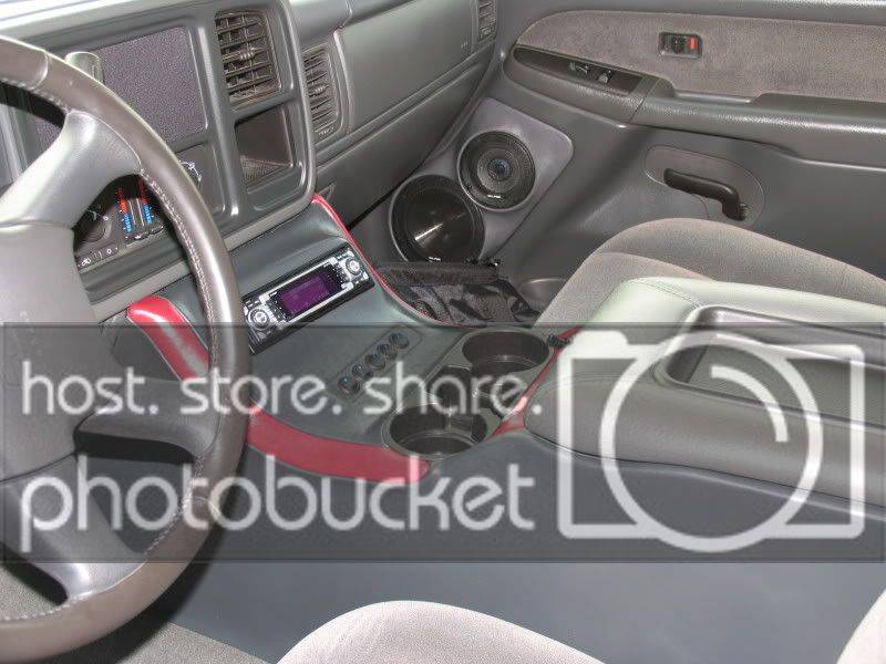

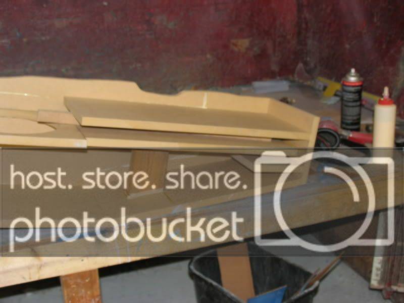

This is my center console with a Orion H2 10. built a ported enclosure and then finished it off with some fiberglass work. OH, this is a 03' crewcab.
