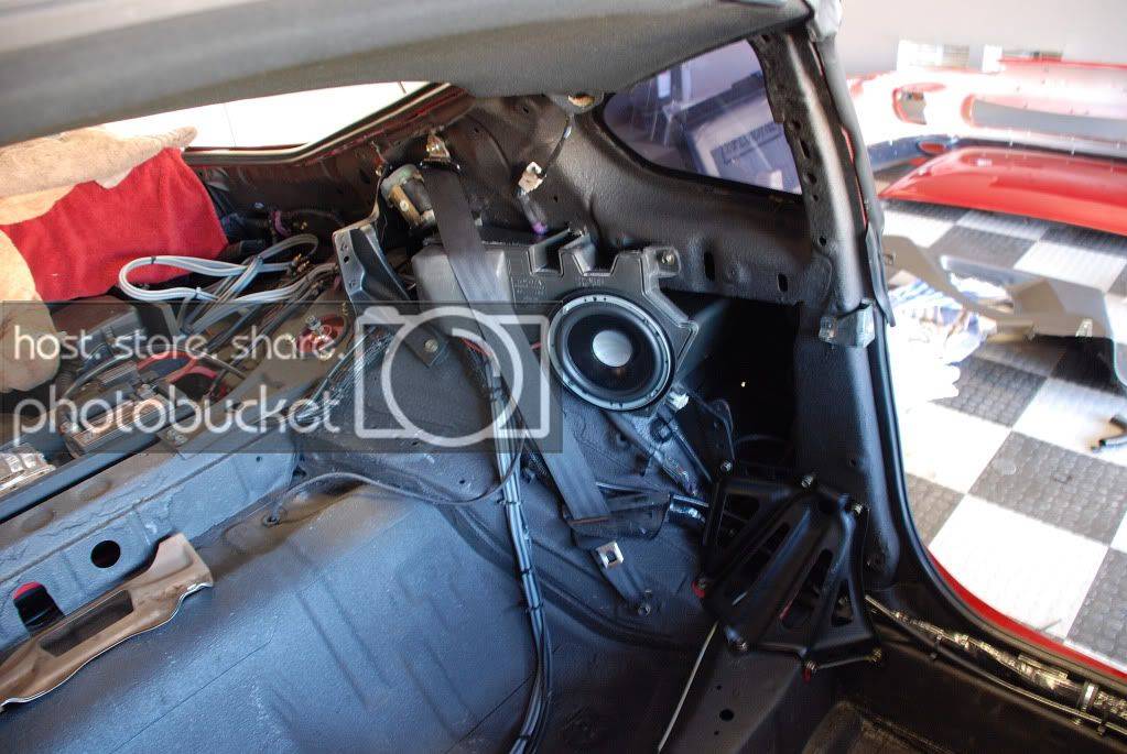

My lows10... thanks for the link.. but do those Speakers require a sealed box or anything? If I did get those.. I would be putting them in my rear quarter panel as shown below..
Budget wise for a Rear spear and Amp ..Just depends really.. I like to stay under $600, but I am a bang for the buck type guy too. I like cheap and good - if that's even possible haha!!
not my picture but a Supra.

it looks like it is a sealed enclosure.also the hd subs would work fine for you too
