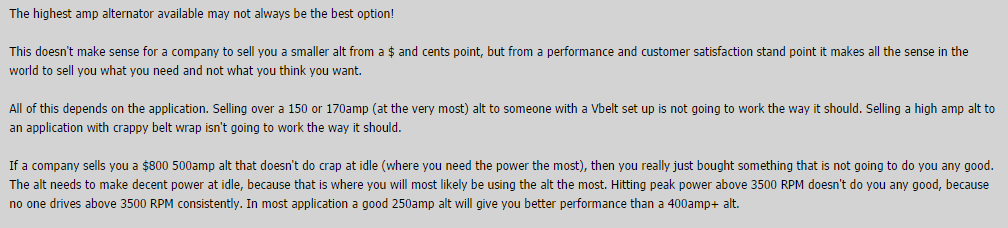

actually it's not always good to overkill with your alt lol
well i overkilled for that exact idle reason the 6 phase 320 gave me the best idl performance and i live in LA so 99% of my driving time i am in traffic idling lol. but yea I'm sure i could've gotten away with a 220 conventional alt
