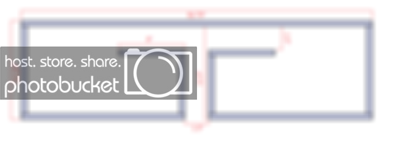

what about 3.5cf after all displacements single chamberd with a 3" wide port tuned to 30hz? theres pics in the 2nd page
just need a confirmation and ill get to building
Looks good, but how far is the T part of the enclosure from the back wall? And if you could, I would try to get a 4" wide port if the length and displacement is not to much for your space.
the port is also 3.5 from the back wall... ill see if i can mess with a 4in port
It needs to be half the width from the back wall when you do a T port like that. If you do a 4" that puts the back part 2" from the back wall which is what I would shoot for in your build.

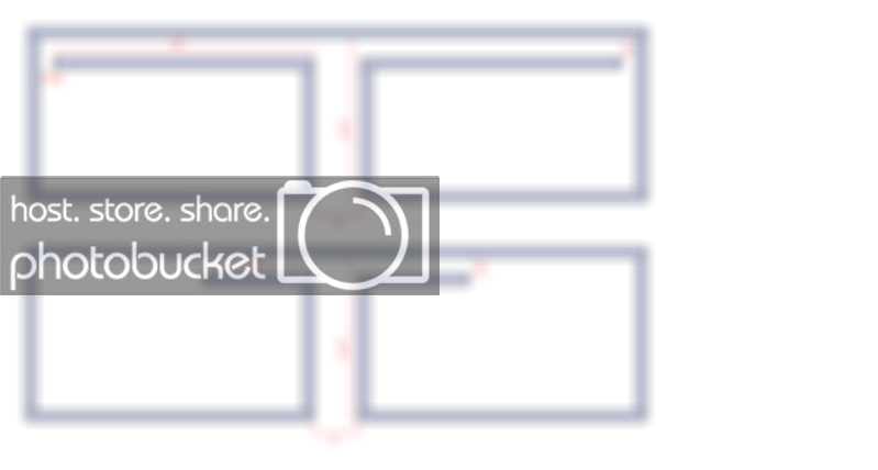

like this??? i dont think the 4in port will work lol
On the 4" version you have to turn the end to come back forward to keep the 2" width available. Also are you dividing out the remainder of the port length(When the T starts) correctly? Looks like you are just putting each side to the full length.
so how would i do that??? port length is 55.5" so 13.5 deep and 21" for each side 13.5 + 21 +21 = 55.5

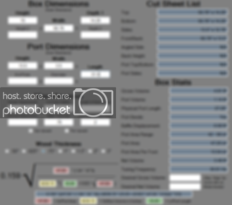

I'm only getting 4.9 gross. Can you go any larger? Just a bit to 5.2-5.3(ish) gross. Port would be 13.5 x 4.5 and 27-28 long depending on tuning.
When you get to the back of the enclosure you subtract your port you already have so you have a total of 27" needed. If you stay with 14.25 deep you would have a 10.5 length. So you still need to create another 16.5" of port. Being that your port would be 2.25" from the back wall you divide your 16.5 by 2. This gives you 8.25 per side you need for length.
And that is my free design/lesson for the week haha.
