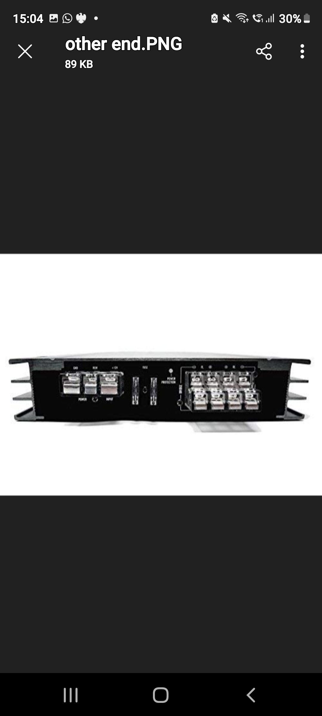

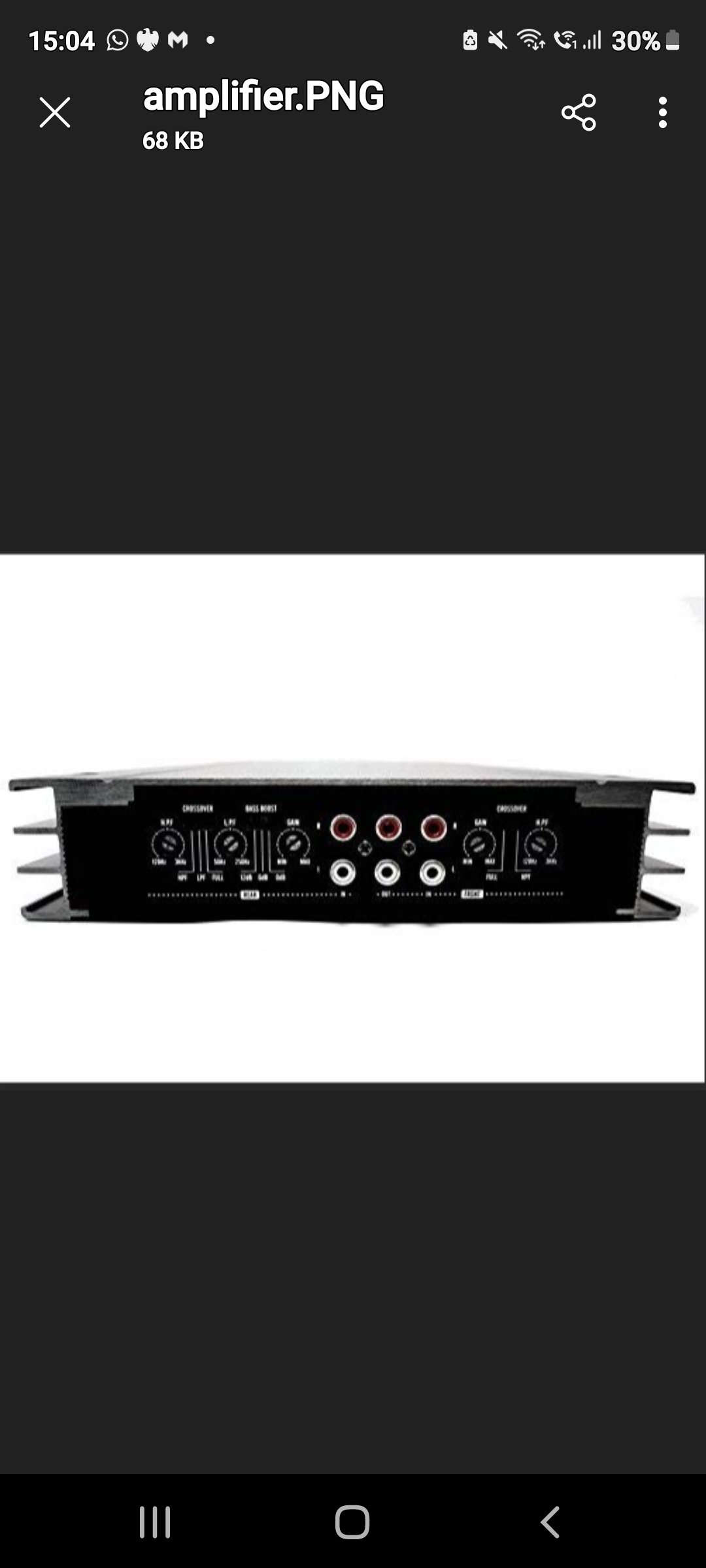

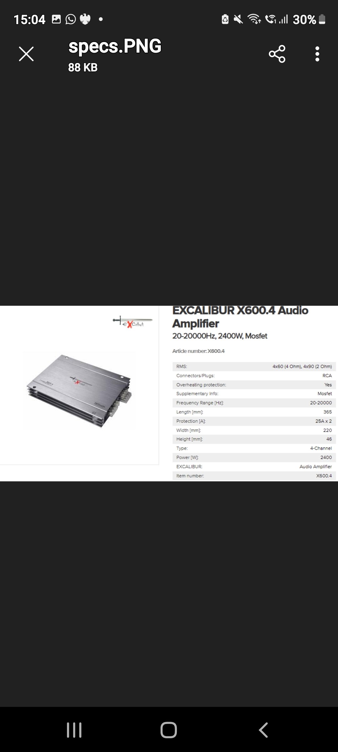

My subwoofers are pioneer t w3254 champion subs x2 and the amplifier is excalibur x600.4 20 to 20,000 hz 2400w 4 channel with 2 Bridge able connections
