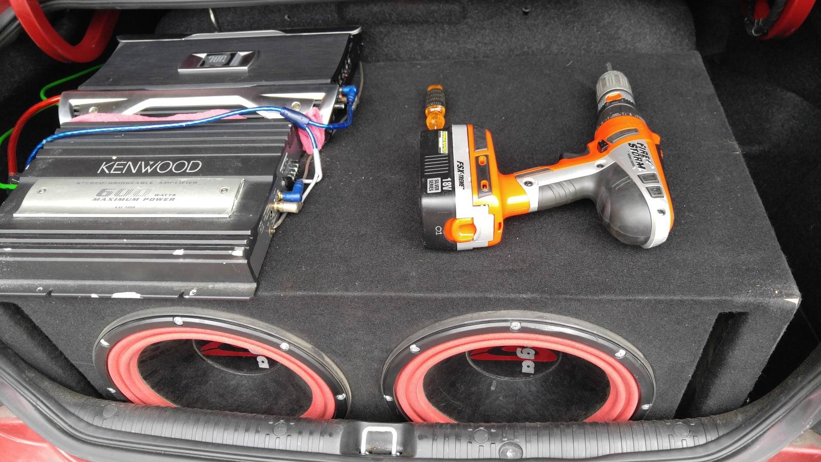

Here's my current box, not sure if I could just put 2 newer/better subs and improve the bass/sound???
