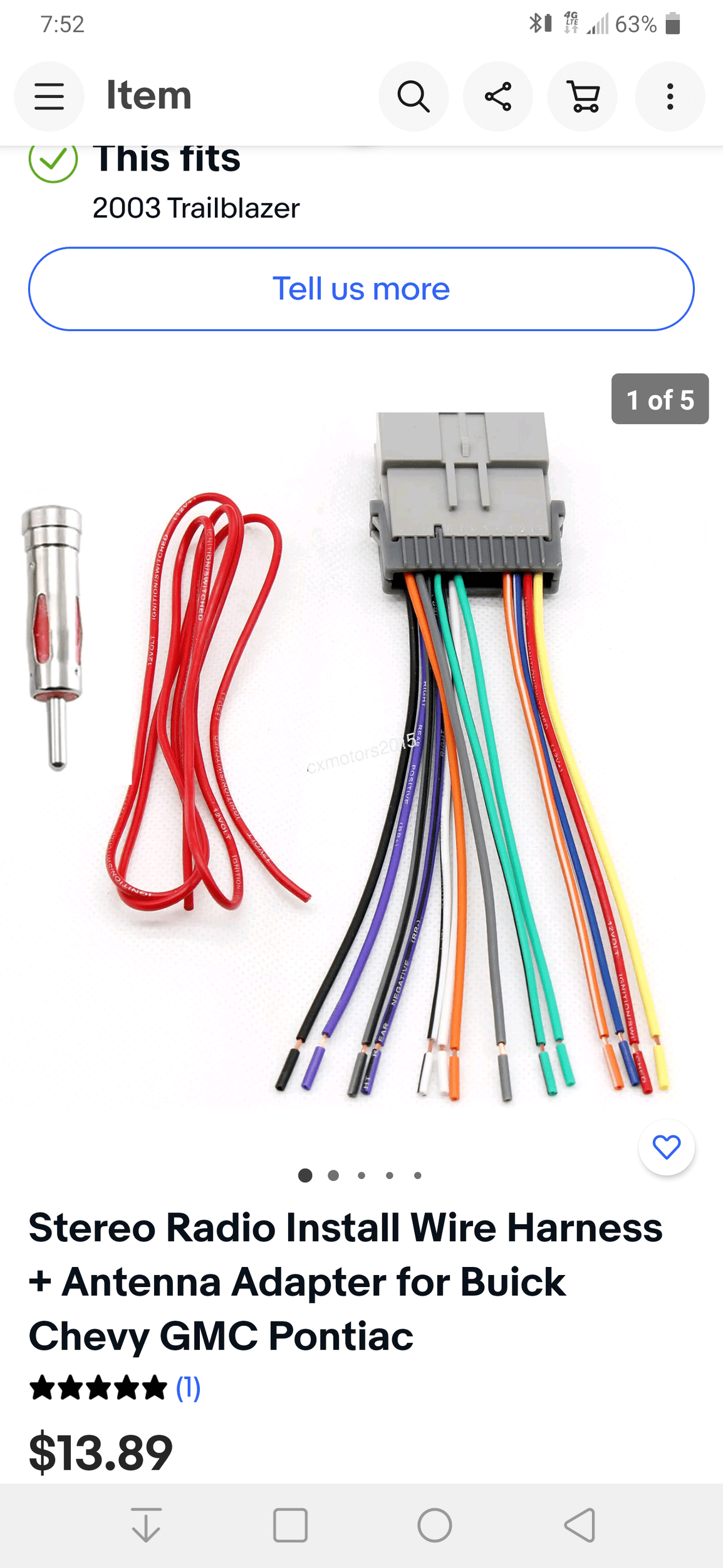

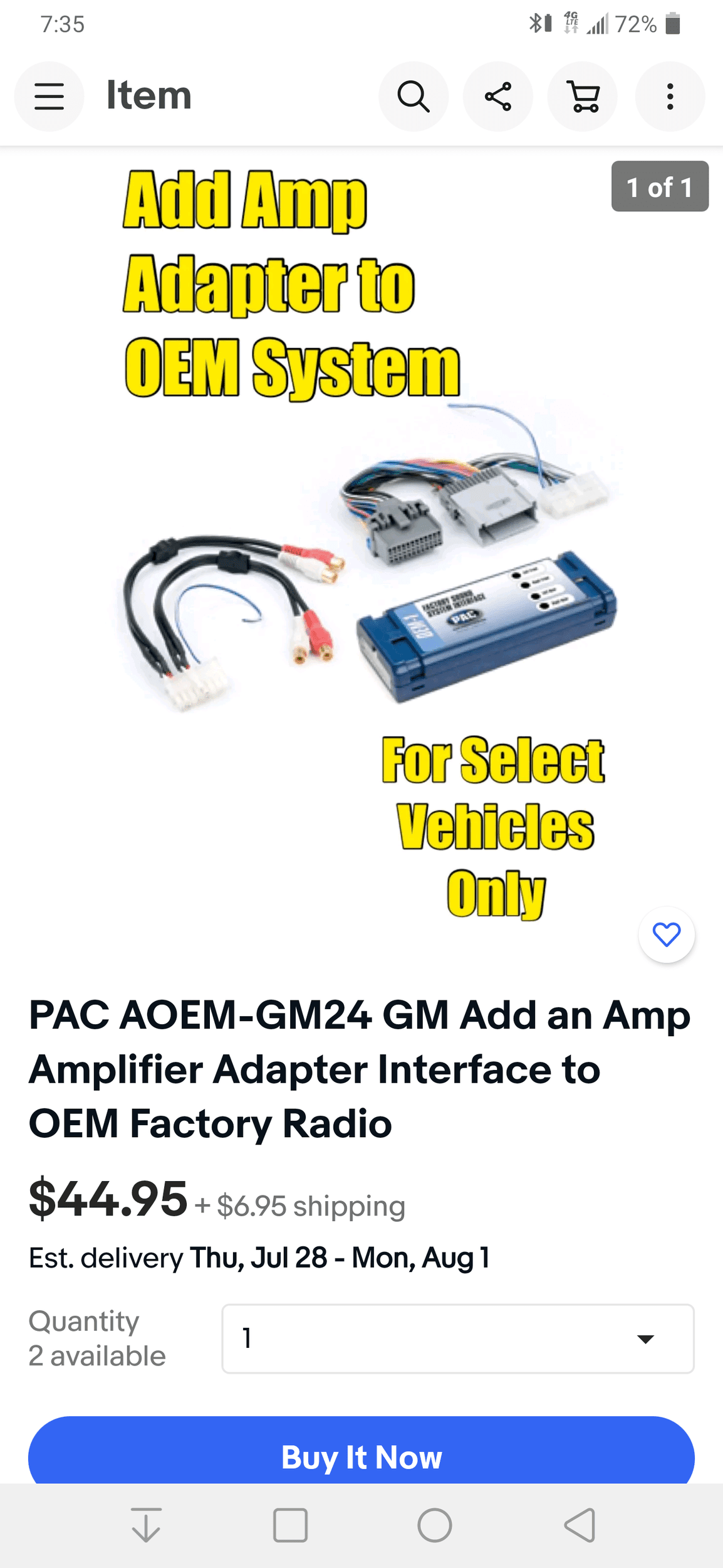

So you have an audio control lci2? If so the directions should be there. You need to take the speaker level outputs off the HU and those go into the lci2, which converts them to a useable signal for the amp. You may want/need a plug/adapter to tap into the speaker level outputs.
I’m not inclined whatsoever to car audio although I’m learning because I’m broke and can’t afford a professional to do it .
Two ways to go about it. First, the easy way-
Next, the budget but more involved way-
On the second one, you buy the harness to install an aftermarket radio,but only use it to identify the wiring. You plug it into the factory harness to avoid confusion while splicing. Each wire is tagged with the speaker location.
