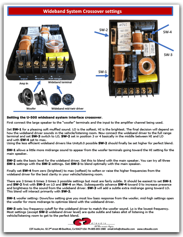

If you want to use a 2-way crossover for wideband and woofers look at U-500 high-pass wideband at 500Hz. https://www.cdtaudio.com/cdtnew22/products/components/crossovers/u500.php
John
‘CDT Audio support beam
Now if I go with the U-500, how the hell do I hook it up?
Would my 6x9 go to Woofer and the Unity 7.5 go to fullrange?
