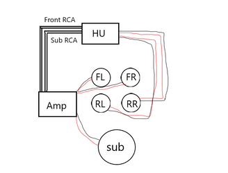

The head unit has 6 RCA (2 fronts, 2 rears and sub L/R), currently 4 of them connected. Can I leave my fronts connected to the amp, wire my rears to the head unit instead and bridge the freed 2 ch on the amp for the sub (using the already installed rear RCA and just moving them to SW RCA on the head unit? (attached image with my connection idea)

Nope. Not the proper way of doing that. Power the speakers with the 4 ch amp and give the sub it's own amp power. Or find a good 5 ch amp and then you can power all your speakers and sub from it. I have a 5 ch amp right now, and have had a few in the past.

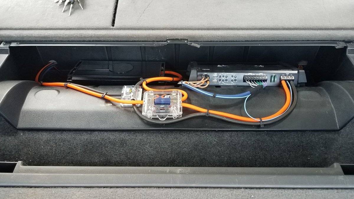

You don't need additional wiring to wire a second amp, idk who or where you came up with that but that isn't true at all. You use distribution blocks for your ground and power wire as shown below in the picture of my current setup.

No don't do it. Your gonna have a hard time making all that try and sound good. Subs are NOT meant to be powered from a 4 ch amp. So what if you have to "invest" more...welcome to car audio. Your an idiot if you actually go this route.
So i get a mono amp and those blocks and do I need to change the fuse on the front of this power cable or can I leave it as it is?

Look at the blue wire in the picture. I used speedwire that has all 9 wires in it, 8 speaker wires for all 4 speakers and then a blue remote turn on wire. What I did was split it off to the two amps. Split it off or run another wire from the head unit. If you are running new speaker wire then get 20ft of speedwire as that is how it is sold on eBay and cut to the length you need and do it as I described.
What you want to do is PERFECTLY fine.  At WORST, it is a step in the right direction.
There is NOTHING bad about using 2 channels of a 4 ch to run a sub -- it has a low pass filter and will work fine.  Actually, it's probably the best way to build a decent sounding system at minimal cost.
Some of these know-it-all's don't realize mono/subwoofer amps just came to the market about 20 yrs ago.   People were putting together perfectly good quality sub setups with their bridged multi-channel amps LONG before mono/subwoofer amps were developed -- some still prefer them.
At <200w you're obviously not going to have the LOUDEST sound around, but it will sound fine at moderate volume.
Don't let all these car audio holier than thou geeks tell you what you want to do is dumb.
Next step -- save for a decent sub amp and bridge the Kenwood to give your fronts more power.  That will allow you to kick the volume up a bit and still have good sound quality.

Way to encourage the OP. This sorta thing might have been cool to do back in the 90's or so but nowadays the BEST route to go is simply another amp separate for his sub only or a 5 ch amp. Did you not read what Jeff said?? The amp is not gonna filter out any unwanted freq if he were to run a sub off it. Terrible idea at best.  I don't see ANYBODY doing this at all. So many amps on the market there's really no need to.
Yup, we know it alls know what we're talking about. Funny how newbies come to this forum "knowing" that us veterns are still around seeking the proper help needed.
OP...sell that 4 ch amp and buy a 5 ch amp. Or just save a little more $$ and buy a small mono amp for the sub.
