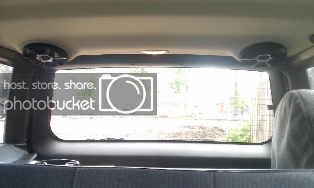

So if you were me, you would take out the Polk mm651um in the rear. Any suggestions on good replacements? I suppose going for better 6.5 mid woofers in the front doors would five me what I'm looking for.

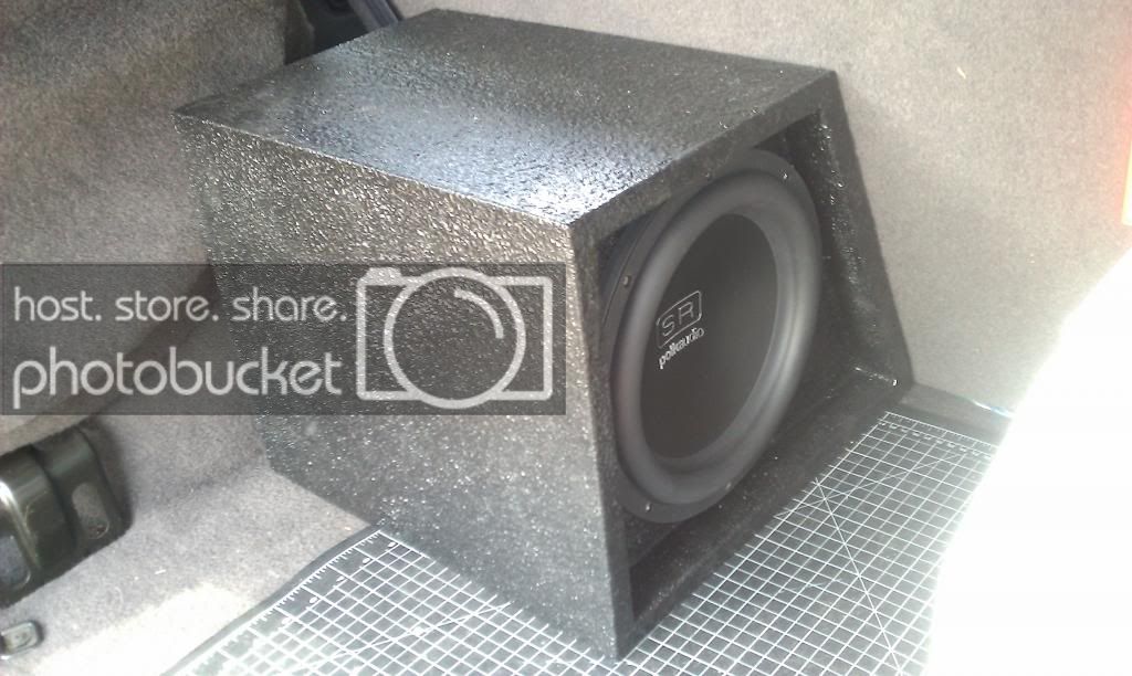

Sub: Polk SR104 SVC (in sealed home made box - 0.85cft)

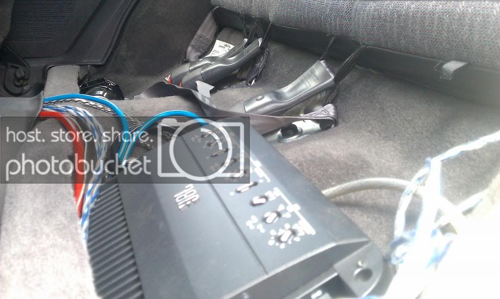

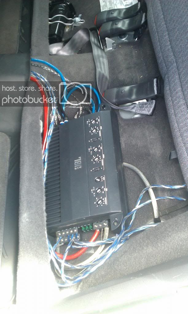

I can stick with the original amp, just worried about my seat kinda resting on the amp due to heat build up or too much weight...ha i guess I could have a weight limit in the back seats? Anyways, I'd like to know if I will gain any noticeable improvements going with a smaller/better quality amp over the GTO-5EZ amp.

There's nothing wrong at all with the quality of JBL GTO amplifiers. They're built really well with a huge amount of heatsink surface area, plus the gain setting system with the included test CD is very nice and unusual. Keep the GTO-5EZ.
Zed Leviathan fits under the back seats of Jeep Grand Cherokee. Even class D gets warm in there. Expect constant thermal protect issues if you don't pick class D. Expect lackluster performance if you don't pick a good class D for full range.
Here's a few pics of the setup...first pics shows fitment of the JBL amp.
Other pics of the system....
Anyways, I guess I'm now trying to decide if I should keep my JBL amp....with the previous mentioned fitment issues. I do have a JL XD400/4 laying around...I thought about using this amp, and purchasing a separate amp for the sub. So it looks like I have a few options based on just that...Also looking at options mentioned by other members.
All in all, the goal is to go in the direction of best overall SQ obviously...Seems like there are lot's of options out there, which is going to work best and why? The list could go on, but I'm certain there's an overall best/ most efficient setup. I could be over complicating things, but hoping it all pays off in the end.
