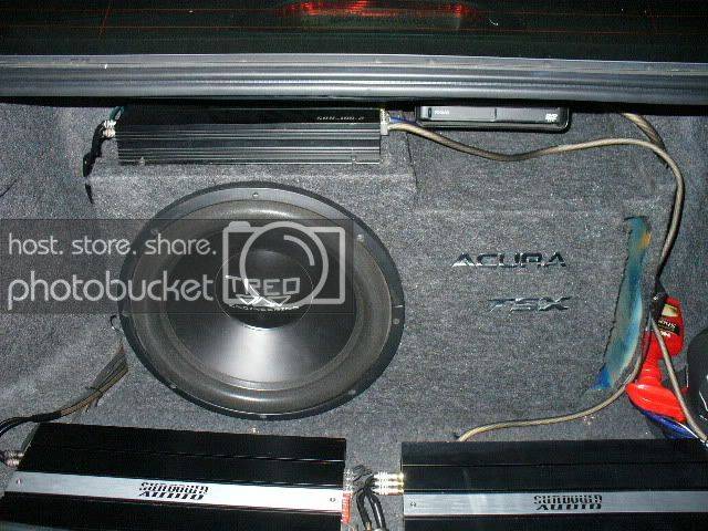

the 15" treo is up for sale too if you're interested. built the box to spec + clears the navi unit in our tsx trunk
