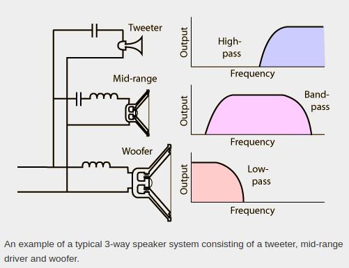

Most apllications in car audio employ a "Component Speaker" configuration. This can be clsssified as either a 2 way, or 3 way setup.
For instance:
2 way= 2 speakers in total. 1 midbass/midrange and 1 tweeter. The midbass/midrange handle all bass and mid end frequencies (vocals and most instrumental content), while the tweeters handle all of the high frequencies (cymbals and all high pitched insrumentation).
3 way= 3 speakers in total. With the addition of 1 more speaker, we can actually assign to that speaker, all of the midrange content instead of sharing it with the midbass as you would have in a 2 way setup. So here we have:
1 midbass, which plays all bass content. (Bass and Drums)
1 midrange, which plays all midrange content. (Vocals and most instrumention)
1 teeeter, which plays all high frequency content. (Dont let the Violins get you🙂)
As is obvious, this is an oversimplified explanation, it gets far more complicated this. However, for the purpose of this discussion the above explanation should suffice.
This is an example of a 3 way configuration.
