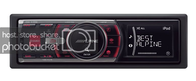

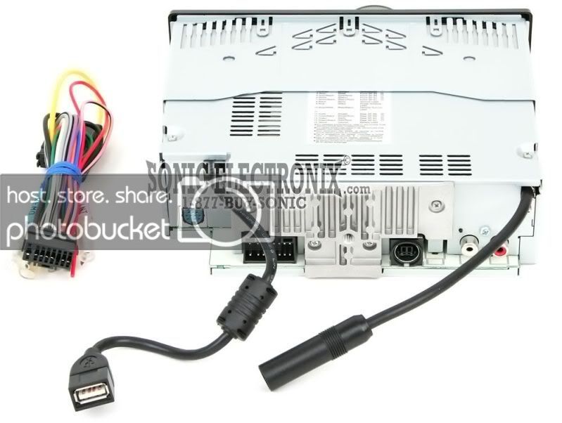

heres the headunit i have(only one output (sub)
http://images.productwiki.com/upload/images/alpine_ida_x300.jpg

you need to go into the menu on the head unit and set the "Subwoofer" to 'OFF"
That should then give you full output on your rca and from there the EQ will do the rest.
You shouldn't be using the subwoofer output to run the whole system. That headunit should have 3 sets of RCA outputs, use the top pair of RCAs and turn off the HPF, you need a full range signal going to the EQ.
It should go
HU Front Output (top pair RCAs) > Main Input on the EQ
EQ Front Output > Amplifier Front Input
EQ Rear Output > Amplifier Rear Input
EQ Sub Output > Sub Amplifier
