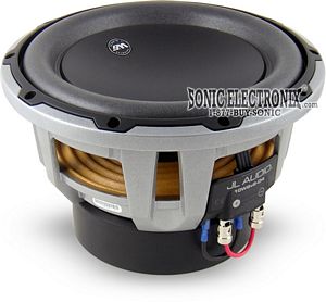

Ok Im getting these subs
Code:
http://www.sonicelectronix.com/item_4009_JL+Audio+10W6v2-D4.html
Im not sure on which amplify I want to get. Would this one work? Im getting two of those subs and not sure if I can have 400x2 watt subs on a amp like this...

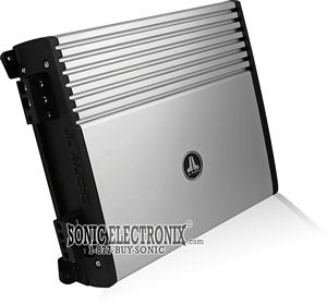

That amp wouldn't power two of those subs well at all. Each sub is 400w RMS while that amp only does 500w RMS @ 2ohms. Your either gonna have to upgrade your budget, buy used, or downgrade your subs.
Best recommendation I have at a low cost would be the kicker zx1000
http://www.sonicelectronix.com/item_6590_Kicker+ZX1000.1.html
$419 with 1000RMS x1 @ 2Ω. do you plan on wiring the subs at 2Ω or 4Ω?
Actually, theres the Hifonics BXi 1606D which does 1100W x1 RMS @ 2Ω and only costs $249, maybe that'll work. Hifonics are overrated so expect maybe 900-1000w RMS out of it, still plenty to get those 2 subs moving though.
http://www.sonicelectronix.com/item_6336_Hifonics+BXi+1606D.html
(this all depends on how you plan to wire it of course.)
if you plan on getting 2 of those subs i would run that sundown amp since the subs are D4 you can wire them to a 1 ohm load which would give each sub about 500w
