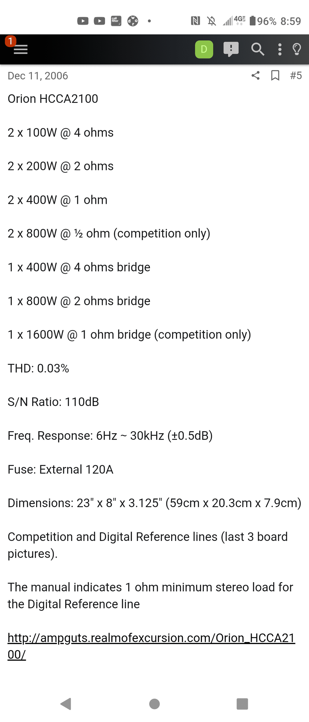

Hello folks. I need help choosing the correct subwoofer ohm/ voice coil combination too achieve what I want to do. I have a vintage, mint HCCA 2100. I want to run 2 kicker L7 square 10" subs off of it in wife's Yukon. As far as I know, the amp will safely do 400x2 @ 1 ohm load.
What ohm and VC combo of subs do I need to achieve this? And how would they be wired?
