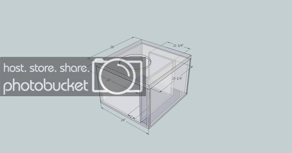

I have tried multiple times to get some help to build a box, but since I have no idea how to figure out my numbers correctly, nobody seems to want to help so I am going to try once again.
I have a box that I have designed I like the design of it, but I don't know if the size is okay and the port and such. A DD 9512 is going in it, it is going to be a daily driver, but i want some AWESOME bass out of it, it is 3.9 Cubic feet before displacement I think.
Sorry this is my first ever upload and even design. Please someone help this time. //content.invisioncic.com/y282845/emoticons/smile.gif.1ebc41e1811405b213edfc4622c41e27.gif
if that box is 24" x 24" x 26" that's 7 cubes gross......I haven't dealt with DD subs but that sounds a little large for a 12" sub........You prob going to want around 2.5 cubes net........
go to SMD Forum and download the TORRES box calculator......it's free and you can put your dimensions into it and adjust until you get the desired size....The calculator will figure the port displacement for you and you will have to tell it bracing and sub displacement....
I downloaded the Torres, I am going to work on incorporating it into sketching so I can still design, but I can't find the displacement anywhere.
