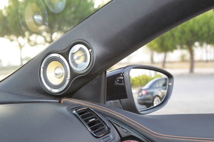

Some general list of 3 ways
hertz mille balanced sound out of the bunch
morel virtus warmer sound out of the bunch
focal K2 brighter sound out of the bunch.
All are still really good and overall balanced though. its nothing drastic
install will look like this with midbass in the doors. you'll need to sound treat your doors too
