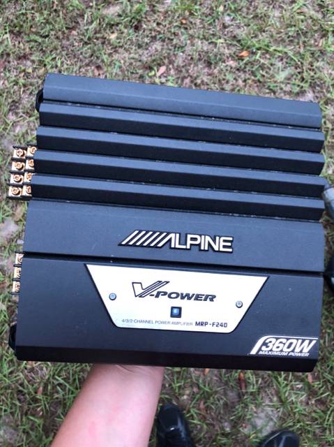

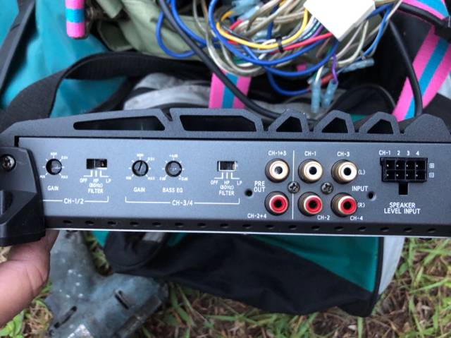

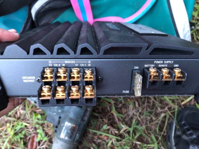

So, this is the amp I had from years ago. Not sure how to test if it’s still good. Also, would this be enough to power my front and rear speakers?
