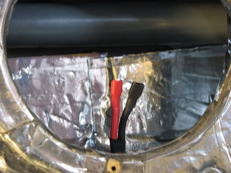

then make sure the speaker wire connections at the speakers themselves are clean - no bare copper showing. i solder terminals and heat shrink over them to ensure no shorts.
