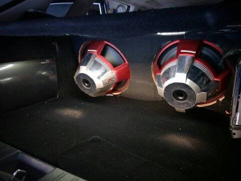

man, what is with you posting unnecessary pics of stuff that has nothing to do with anything? Your advice is good for resolving this issue, but the pics.....

Maybe that's how they roll in the outback idk. I've seen my fair share of infinite baffle set ups lately. There's a random picture thread for random pictures. The ones he post seem very random. The guy does try to help people out.

Yeah, I do try to help out since I have been delving in car audio for the past 30 years and have done a few installs.  The pics are random but that's how I roll mate!
