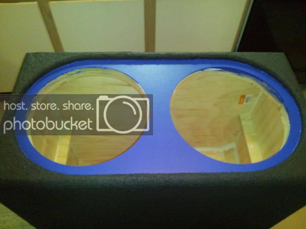

Hdc4 box build
Pics of painted face and port coming ..btw its 4.5 cubes@32 with 17.5" of port ..made from arauco. Face is 3 layers thick including the flush mount..face is 3/4 routered and rest of box is 1/4 routered. Box is coated in roll on box armor similar to rhino liner but made for wood
