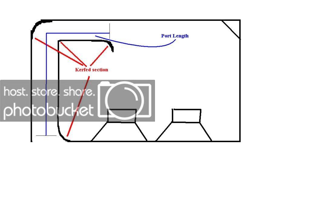

Im going to build it slightly different. 36 wide, 19 deep, 13.5 tall. port area is 48" tunes to ~34 hz. This will seal to the cabin of my car better than 32" wide. I only need a small foam gasket to seal it off if its 36 wide.
I want to try to do a kerfed port opening as well as for the port bend. You only count the opening as half the length right? ie. if the port flare is a 4" radius only 2" will count to port length?
Heres a pics. Notice that the blue port length line dosnt go all the way to the ends of the port openings.
