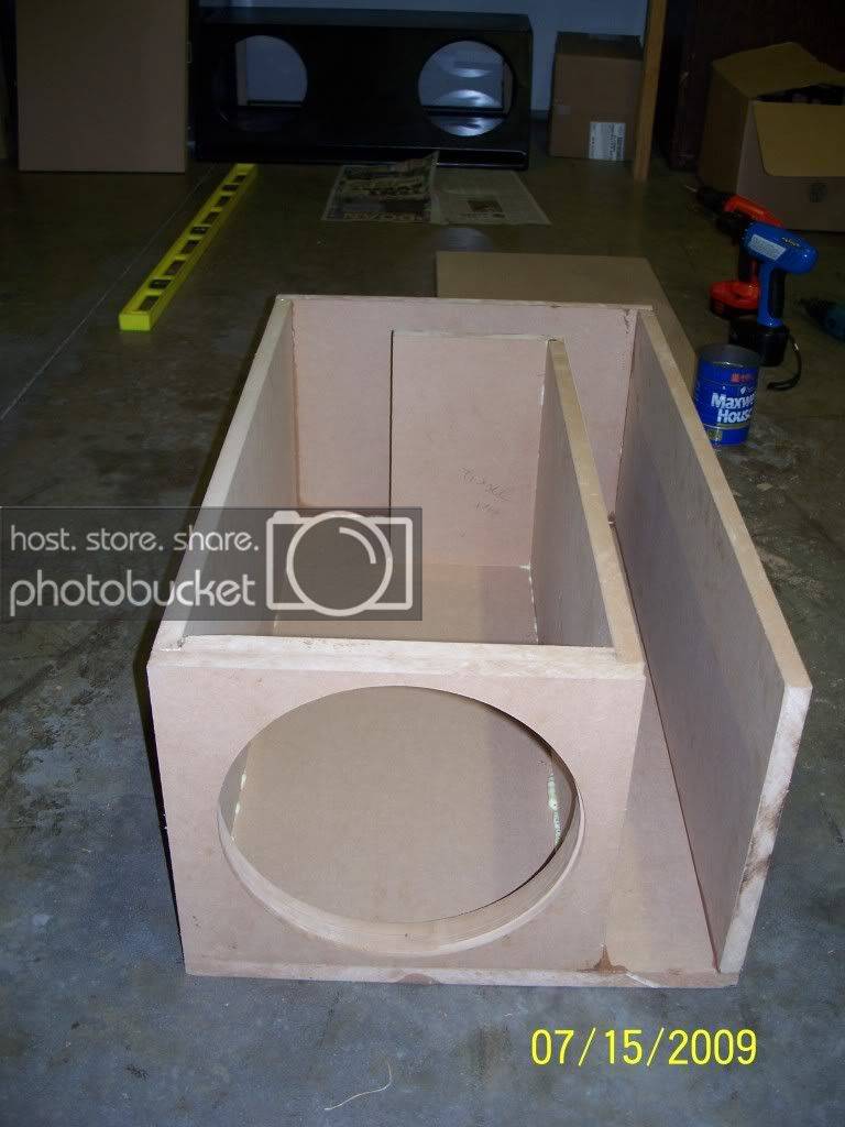

ok so now that you have thought about that for a minuite i can tell you i hav an atomic 3000.1d amplifier, and my enclosures spec out to 2 cubes net tuned to 37hz.
heres some pics of the box, the dimensions are 18.5 wide, 13.5 tall, and 31 long, the port is 4" wide x 12" tall. The port wall lengths are 26.25 and 8
The RE calc says its 2.329 cubes @ 34.46hz but that calc doesn't factor in the double front baffle or driver displacement so thats how i get my numbers for volume and tuning.

Your net volume is 1.93 and your tuning is 38.7, so your numbers are a bit off. The RE calculator sucks so I would find a different one if I were you.
That aside...you can still push your subs past their limits above tuning when you're giving them a lot of power. Have you checked to see if your box has a leak or a weak seam somewhere? Could be frequency dependant or something....

Box was built using gorilla glue and definitely does not leak. This is like my 10th enclosure build so im not a novice and ive never had a problem like this. I guess i need to try a new box.

How do you figure the measurements you calculated? i was think more around 2.1 and 37 hz
