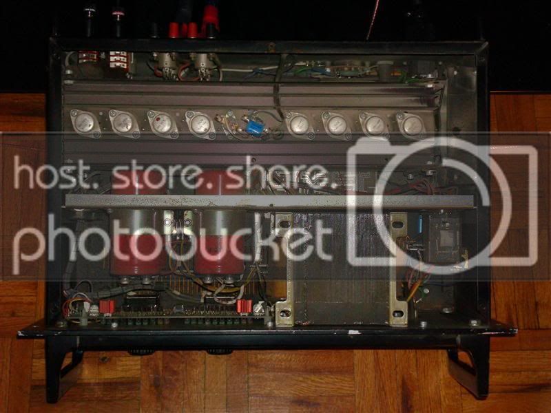

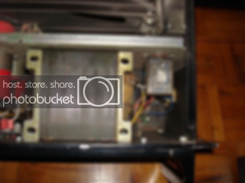

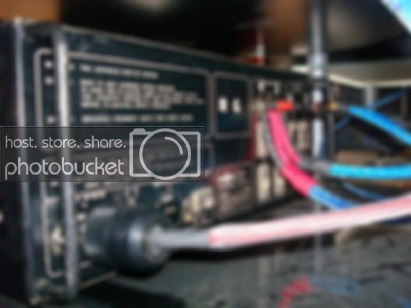

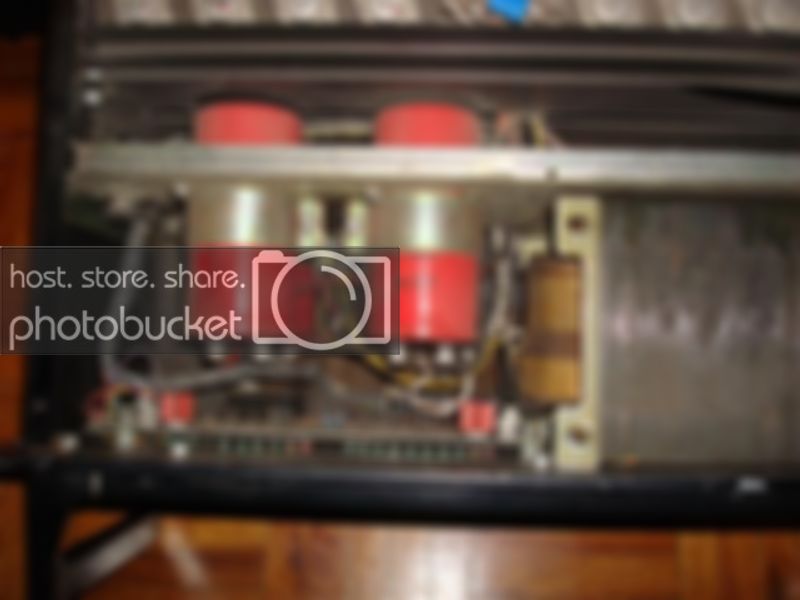

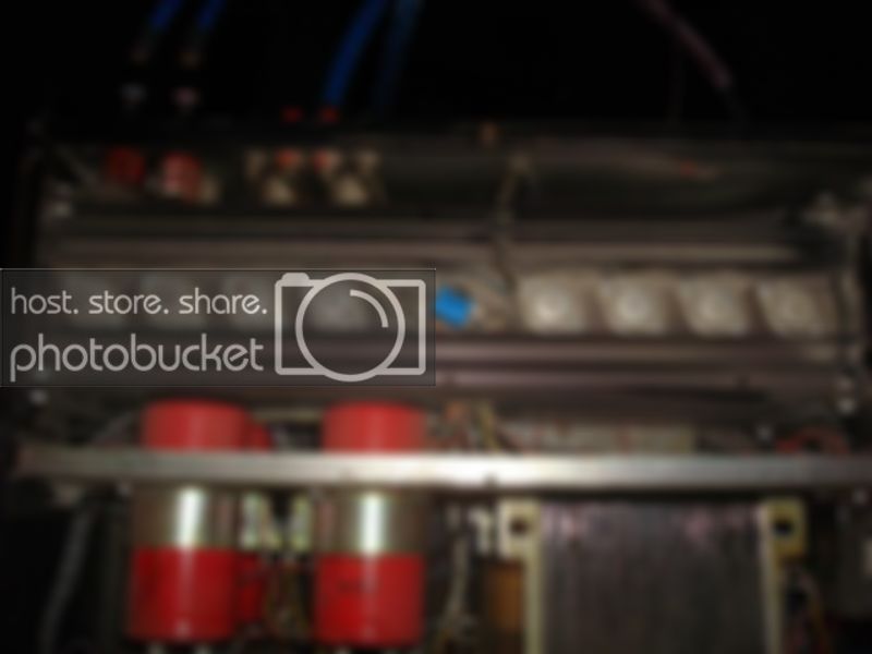

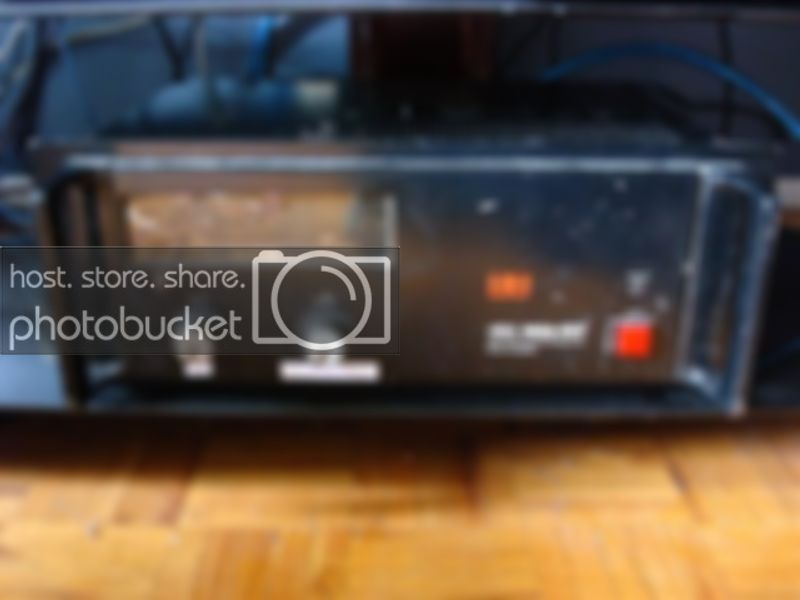

Here are the pictures of the one that I have...
200 Watts x 2 at 8 Ohms
400 Watts x 2 at 4 Ohms
800 Watts x 1 at 4 Ohms
I know H||H was purchased by Laney sometime in the late 80's early 90's. Also, H||H Audio amplifiers were designed for use in BBC recording studios. So I think they were designed and used with the original PMC monitors.
200 Watts x 2 at 8 Ohms400 Watts x 2 at 4 Ohms
