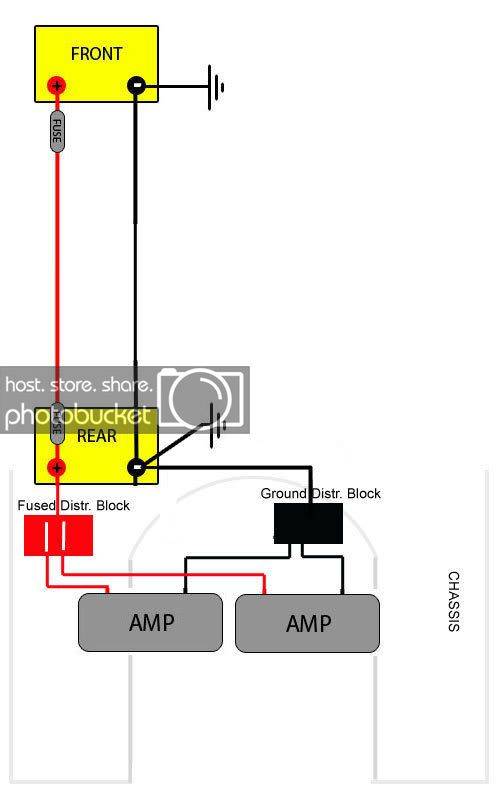

Some people say to run a dedicated ground wire from the battery neg under the hood to other batteries and amps in the back. Others say to keep ground wires short and connect them straight to the chassis.
Would it work to run a ground wire from the front batt to a spot on the chassis in the back of the vehicle...then ground your amps and/or batts to that same spot? That way, they have the "direct" ground to the front batt negative, but also they have the chassis as a ground path as well.
Would this cause any problems like ground loops, noise, etc?

Take a look at this diagram I made, it should tell you all you need to know:
You should actually do both. You should run a dedicated wire and still ground locally as well. Yes that is an extra cost and more wire to buy. Are you asking what is the cheapest way to do it, or are you asking what is the best way to do it? This is the best way to do it.

The one factor you forgot here drew is that the wire size plays an equal role to the distance when considering the impedance of the wire. If your wire is long and fat, it may have the same resistance of a short skinny wire. If you think that a 15ft section of 1/0 has more resistance than your RCA cables, you are mistaken. If you think that same 1/0 has more resistance than 10 chassis welds, you are mistaken.
Explaination: A steel vehicle frame has a higher resistance than a copper conductor, for the most effective tranfer of current, a conductor should be run for the ground.
loop, can you tell me if this works??
