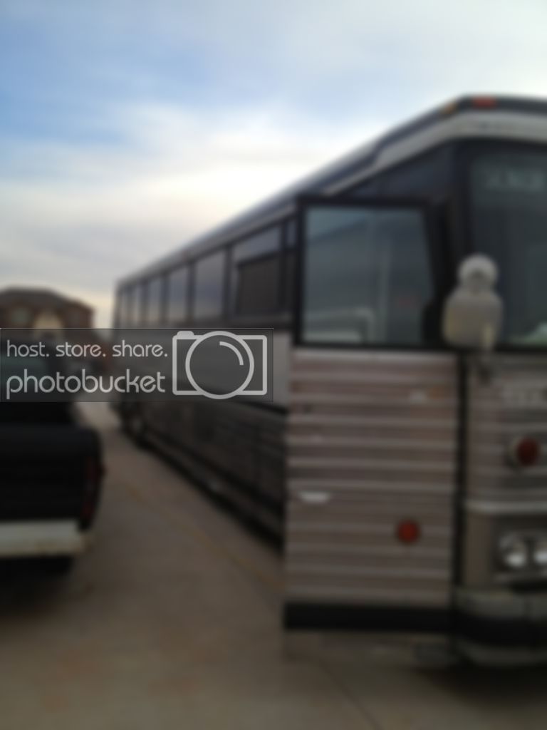

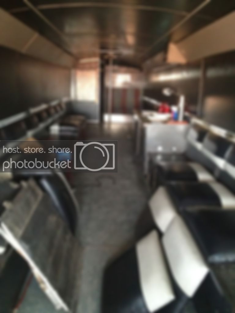

Just a few pictures to show everyone what im working with. Started deconstruction so the inside looks a little rough but it's nothing more then a few cushions moved around. It's going to be challenging but should be fun as well.
