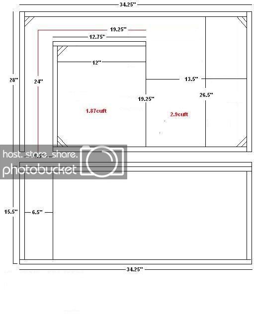

Here is one I did for my 15" btl
4.5 cuft @ 33hz @ 90 square inches of port area.
It not 100% finished.
I have to figure out bracing displacement and what not but just a ruff 5 minutes and got a good idea.
Few more and it will be done.

do you have any options on that btl cuz that box seems to be waht im going to do aswell i was going to tune a little lower maybe

Is 36^2 enough port for those subs? If not change the xmax to get the desired port size. I've built 5 boxes with that program and they've all sounded fine.
Use about 12-16 square inches per cubic foot.
I like to use alittle more on a sub that moves alot of air.
