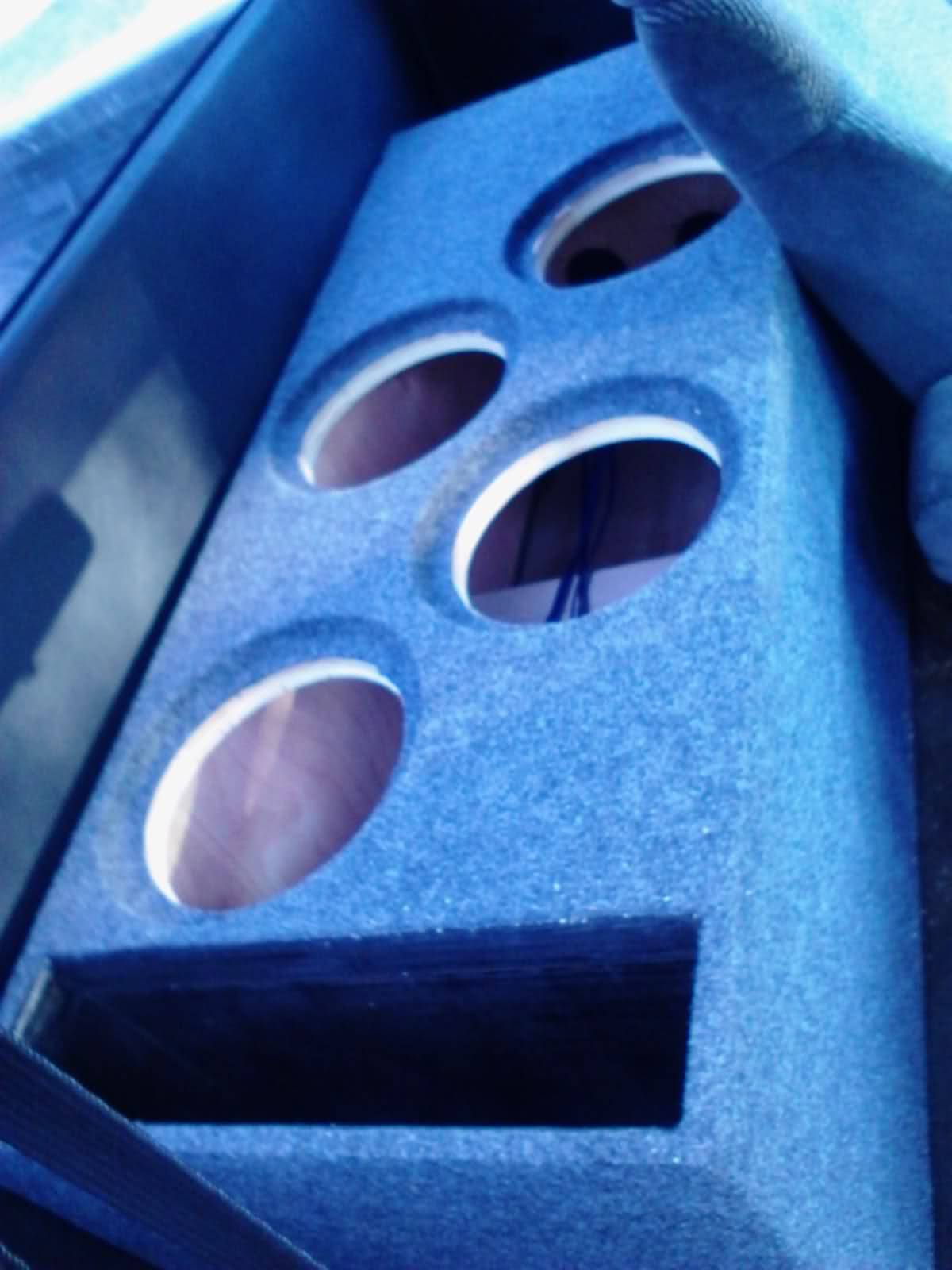

3.5 net @ 32-33 hz for 4 Skar 8s. Double baffle, flush mount. All birch construction. Great work as usual rabbit! //content.invisioncic.com/y282845/emoticons/smile.gif.1ebc41e1811405b213edfc4622c41e27.gif Going to get everything in and playing in the next few days so I'll let yall know how it sounds soon!
I always thought it was a bit of a waste to make a birch box but then cover it up in carpet..nontheless looks good.
Actually I wanted it bare, but there was a mix up and one of the helpers at the shop carpeted the box. Not a big deal since I was most likely going to end up painting it with a textured paint and I still can with a little sanding. Birch is best stained, but I've had stained boxes and want to try something different. The weight reduction was the main reason for the birch in this scenario btw.
Yea, thats why we all use Birch! Lol. MDF weighs too much //content.invisioncic.com/y282845/emoticons/frown.gif.a3531fa0534503350665a1e957861287.gif
shipping weight on this was still 60lbs. MDF would have been probably 100lbs . //content.invisioncic.com/y282845/emoticons/biggrin.gif.d71a5d36fcbab170f2364c9f2e3946cb.gif
Looks good in there.
Yea, it was my fault on the carpet. I had it sitting by(not in) the area where enclosures sit while waiting to be carpeted, and while I was gone it was wrapped up.
Nice enclosure Morals. I bet that setup is pretty sick in that hatch! Hoping the skars live up to my expectations... I'm working on wiring up my batteries right now (at work //content.invisioncic.com/y282845/emoticons/laugh.gif.48439b2acf2cfca21620f01e7f77d1e4.gif) hopefully can have this set up going in a couple of days!
