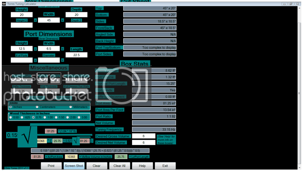

goog box for 2 Phoenix Gold elite 12s?
finally figured it out. my box comes out to 29.83hz. 62.50sqin port area at 10.42sqin per sqft
ill be honest, no idea what most that mumbo jumbo is (for now)
raise the port area per cu ft, raise the tuning to 33-34ish, just pm me and I can help you design one if needed. free of charge.
