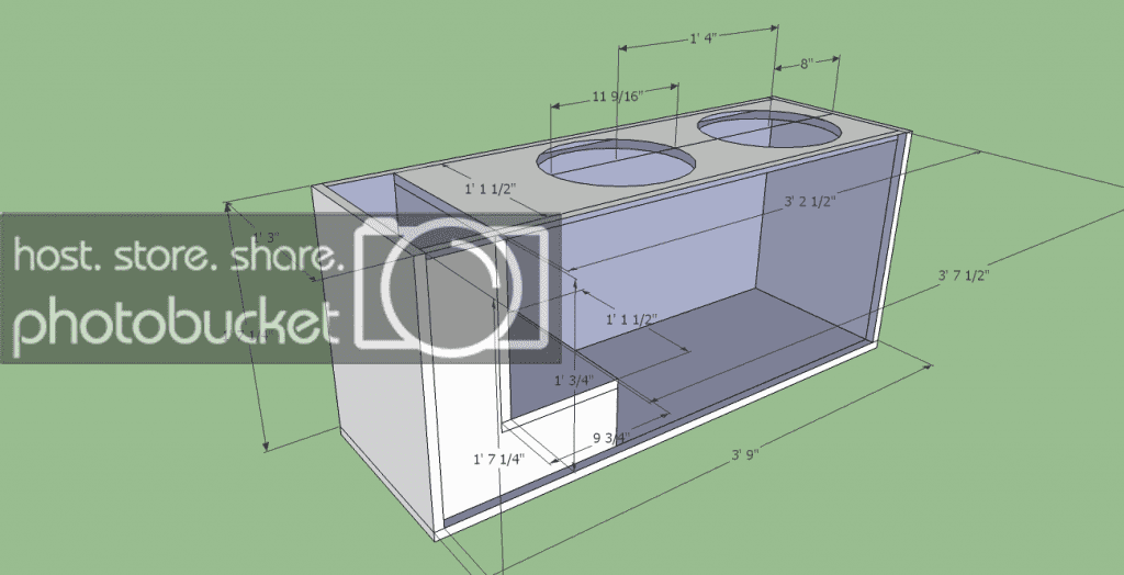

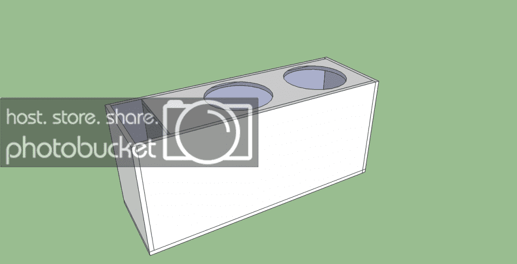

ive spent the last few hours on sketch up making this box for my Elite 12s its 6.2cuft tuned to 30hz (i used the12volt.com calculator for port length)
the ports aprox. 22 1/2" long and its 5"x13 1/2"
please gemme a break cuz this is the first box ive ever designed myself. i will be adding metal bracing to the insides.
sooo what do you think? the owners manual on the subs says for 3.0cuft per sub at 30hz and i figured after displacement and such it should be close to 6.0cuft
YES I realized the titles screwed up. I ment to say good.
if it 6.2 external cubes its going to be alot smaller on the inside im not home and i cant remember what box calc i use you can google it and download it i think from diy.com
go subs up, port up, port in the center. it will peak the lowest, burp the loudest, and be the loudest to the ear. and choke down the volume to about 2 cu ft a piece, go with like 14-15 sq inches of port per cu ft.
ranger danger has a ranger so he will know more about that than me and @RangerDanger ; i think he might be close to that cause he is at 6.2 external... and i didnt mean to give a link lol stevemeadedesigns.com lol is what i ment

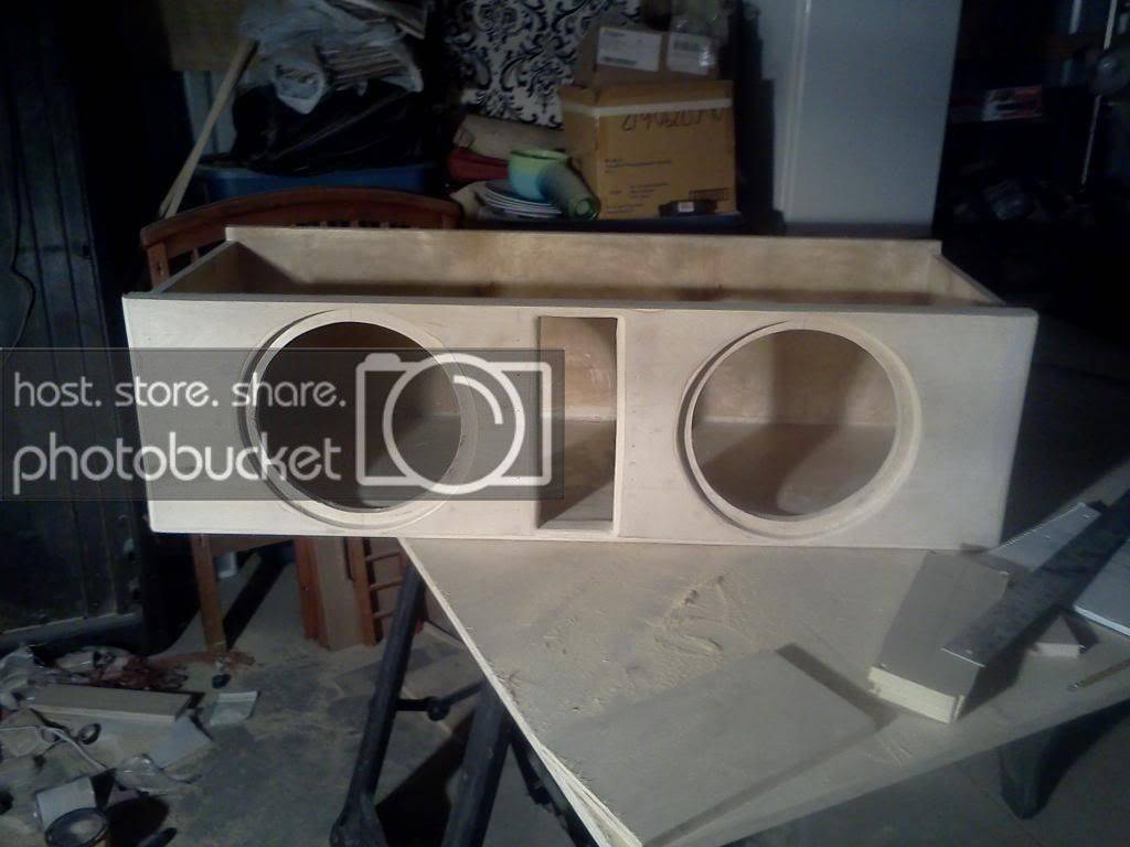

thats what i was told to do but i have very limited tool acsess (a skill saw and drill...) and wanted to do the easiest way. i dont want all spl. i still want it to pound music.
this is being built with a skillsaw and a drill....
a lack of tools should not hinder you lol
