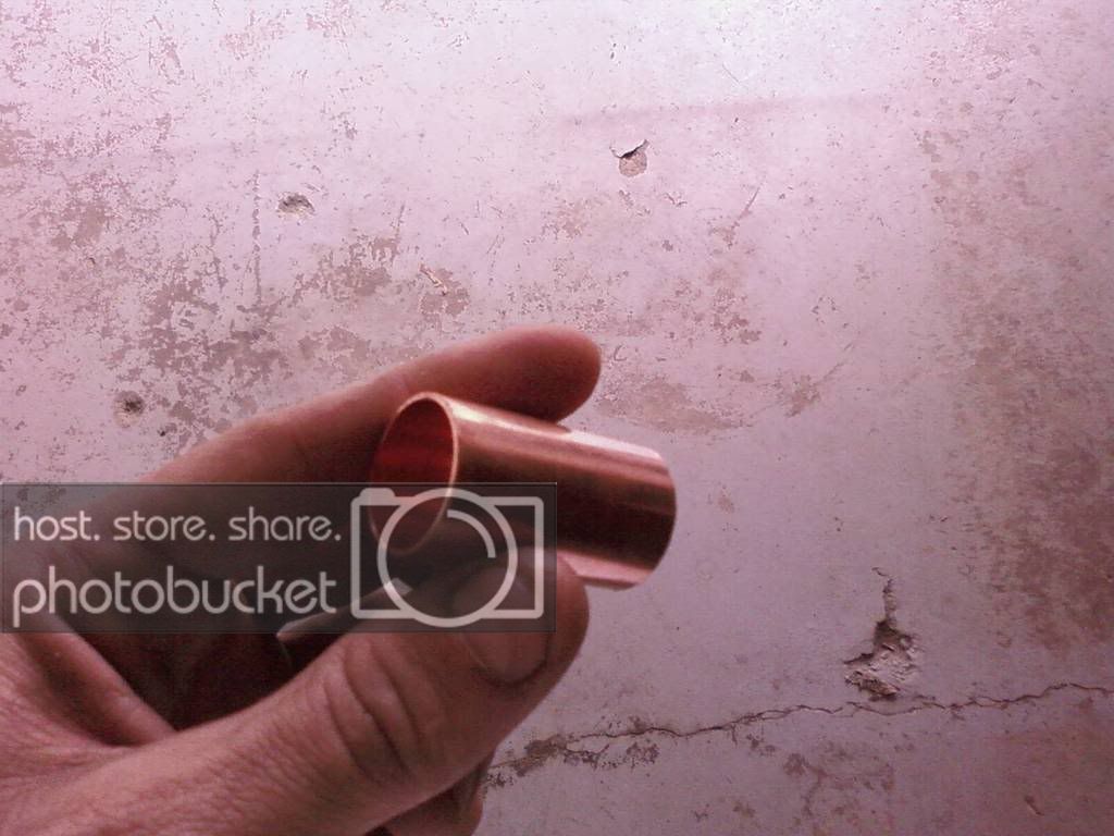

good idea for big wire ring teminals
lincolntc690
3/4 in copper coupling fits 4/0 perfect

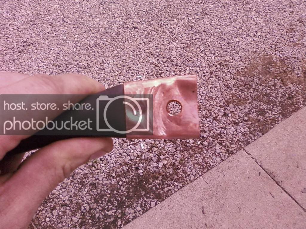

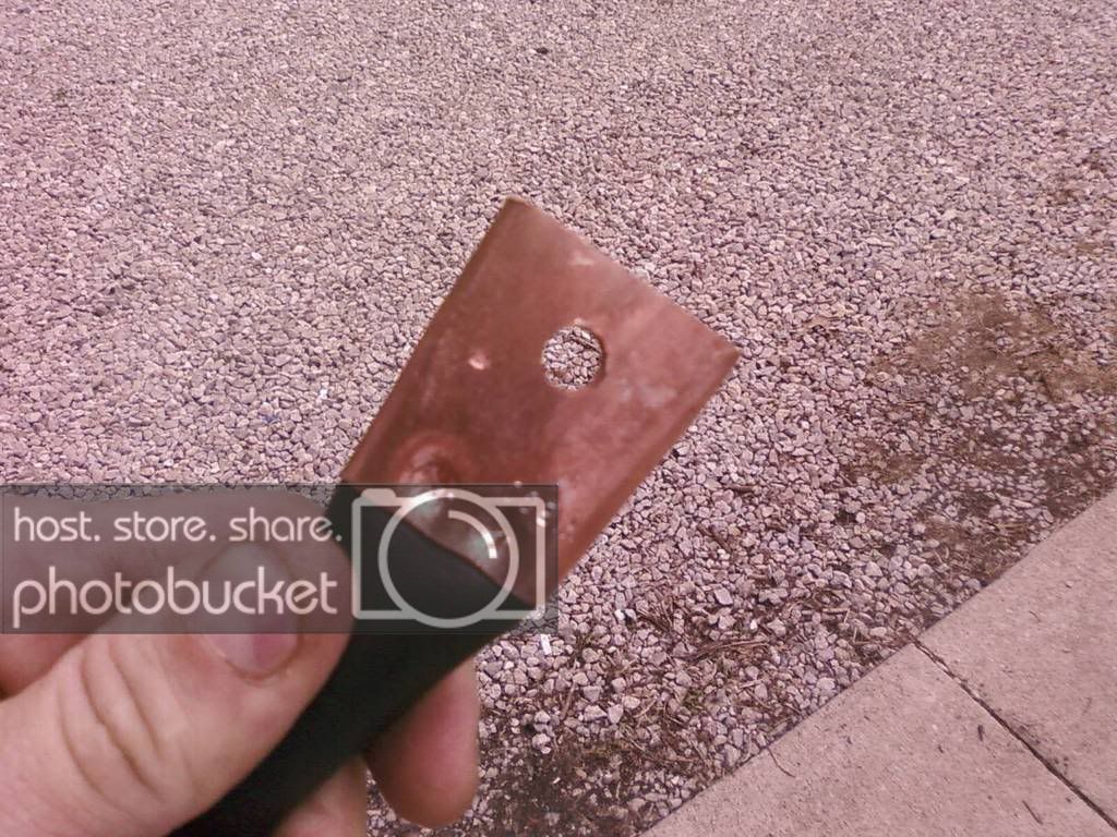

pounded around the ins and bare wire
punched for added support, and drilled to size
10 pc bag at lowes for $6.80

easy to drill thru. i actually have the wire almost all the way to the end and drilled thru it also. good idea about notching it, but i was trying not to cut it. the punches hold it pretty good, i put the end in a vice and gave a few good tugs on it. i am gonna round the ends a little tho

//content.invisioncic.com/y282845/emoticons/fyi.gif.9f1f679348da7204ce960cfc74bca8e0.gif I've seen this done many times before as well as done it myself for installs that I didn't care about looks. //content.invisioncic.com/y282845/emoticons/thumbsup.gif.3287b36ca96645a13a43aff531f37f02.gif
