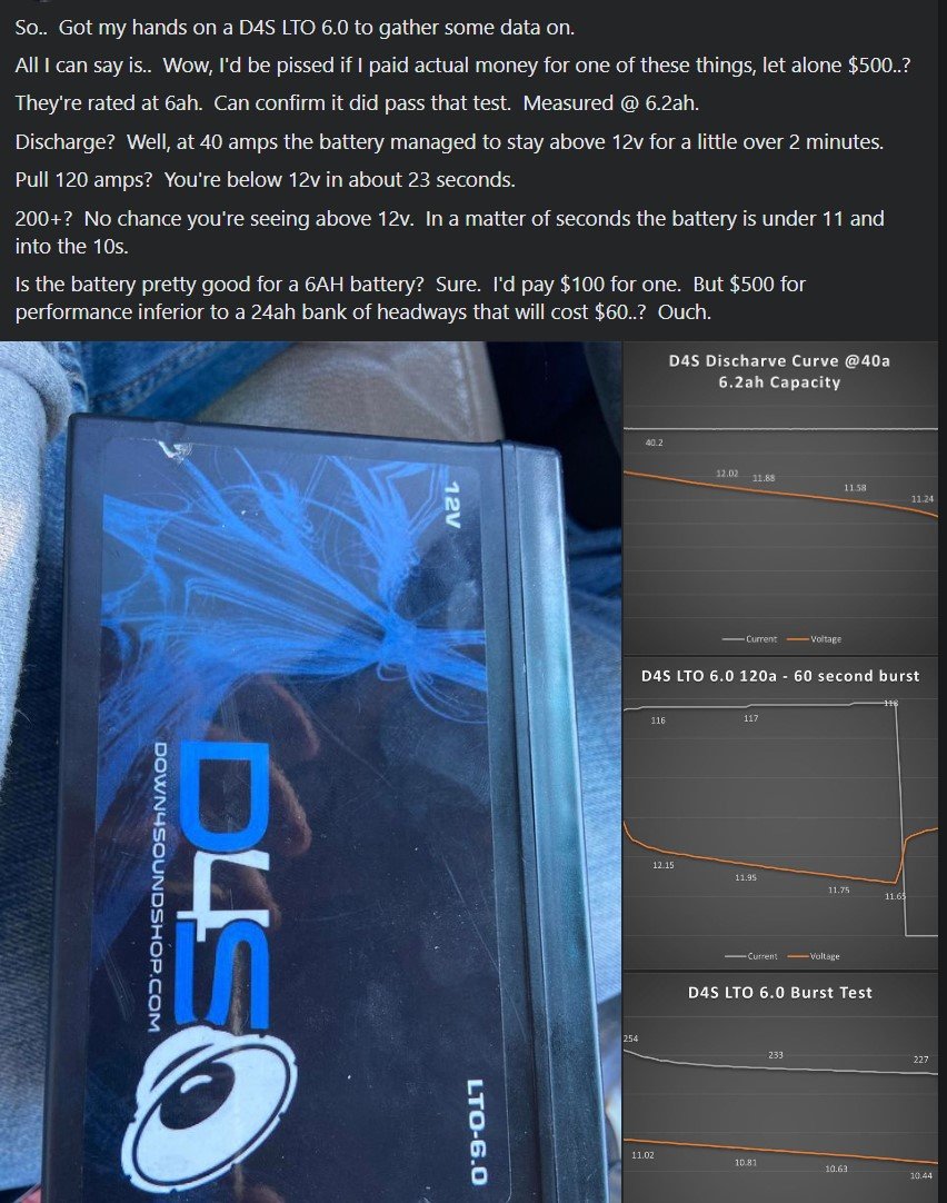

From what I have researched the best deal on a lithium designed for car audio is DownSounds brand one. https://www.down4soundshop.com/down4sound-d4s-lto-6-0-12v-lithium-battery-3000-5000w/
God no. That is the WORST car audio lithium...

a reasonably priced battery/batteries that can run a 1500 watt system for an hour or 2 with the car off.
The one you linked is still a bit iffy if you intend to push things. Consider the cells are rated 100A Max discharge which means if they're the common LiFePO4 cells you see on alibaba lately the continuous discharge is more along the lines of 25A. Also consider that they pitch this for "trolling motor" which would draw about 14A at full throttle. I'd say 4 of those would probably do what you're after but that does not seem cost effective.
