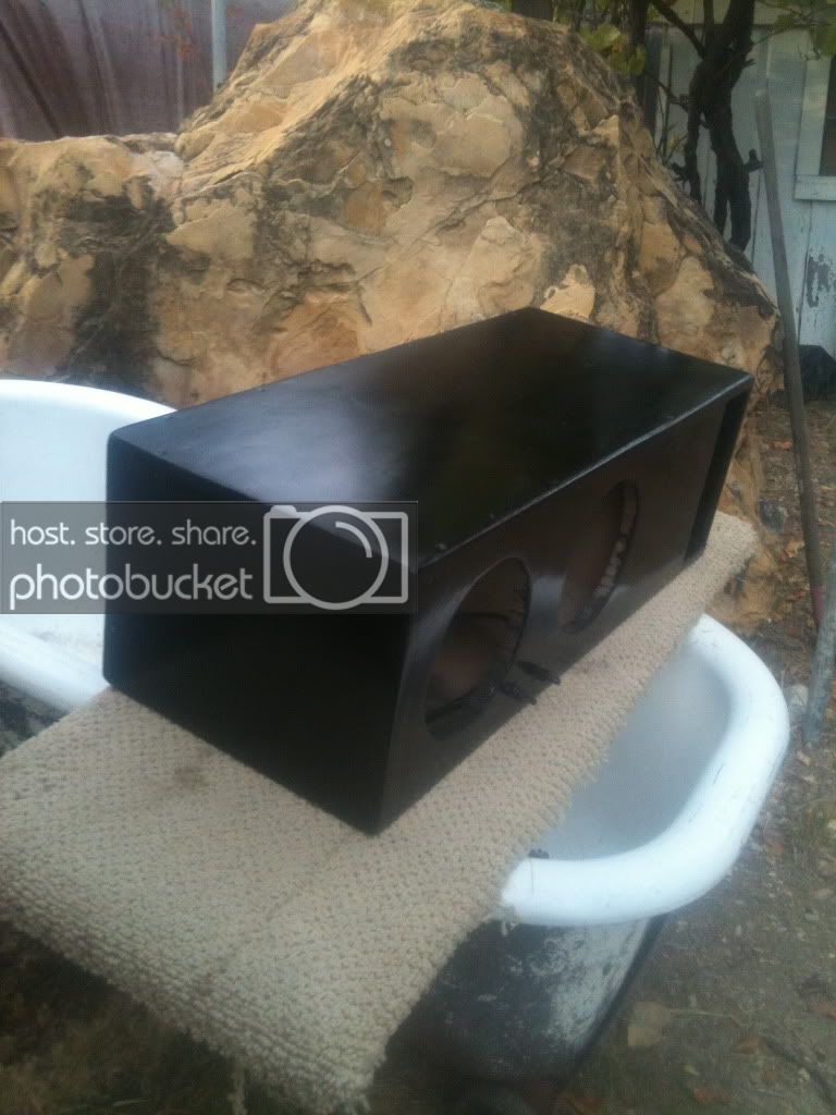

pics of the box ,here's mine i just built for my dc 8's
