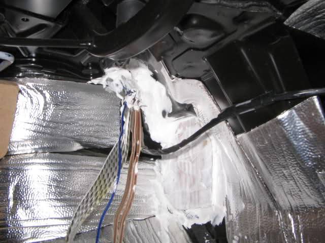

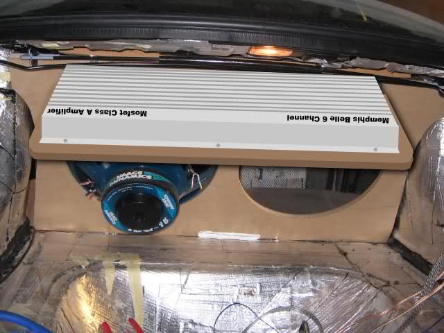

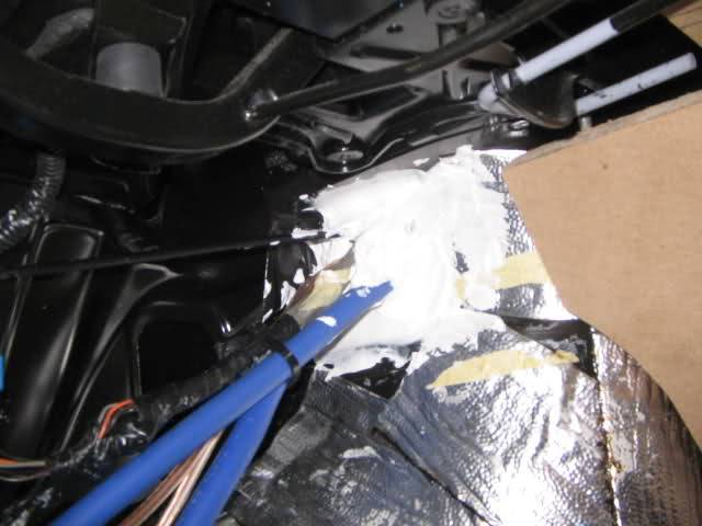

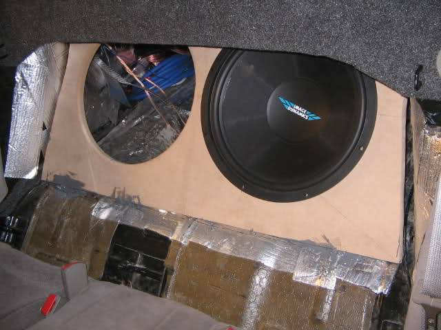

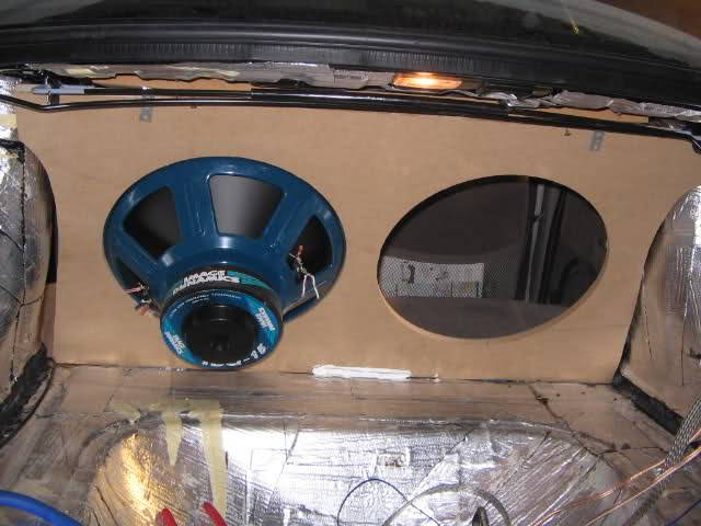

i got a lot of work done today, for some reason i was ambitious! so i got my router bits all sorted out, cut some IDQ holes [ IDQ15's are 6 15\16" mounting radius for those of you who are interested ]. i then rounded one side off with a 3\4" roundover bit and then i moved my wires from the floor of the trunk, up the sides of the rear seat area behind little inserts and thru the rear deck into the trunk from eaither side. i caulked the areas that were open up there [i ran out of caulk, i need to seal up two or three other small areas], and i screwed in my IB board.
as you can see, there are small gaps round the whole baffle, but im getting a few tubes of liquid nails to sort that all out. got some metal brackets up top that hold alot of the weight, and i got six or so screws going thru the metal skin of the floor there for some extra support [and yes i got under the car and looked, they are fine] the liquid nails will hold onto those screws for alot of added strength [think rebar in concrete].
here are my new 5 channel MEMPHIS 17' FLAT RIBBON interconnects - awesome awesome wires for under $20 - they are so easy to install under carpet and crap its unbelieveable. thats the right side speakier wires and remote line as well. and a ton of caulk sealing it all up
heres the driver side rear deck area - both 1\0 runs. one is power and one is ground - the ground is connected to one of the bolts for the rear strut up there, and the power goes all the way up to the engine, and two more speaker lines for the driver side mid\horn. and again, tons of caulk.

you talk about caulk alot //content.invisioncic.com/y282845/emoticons/crazy.gif.c13912c32de98515d3142759a824dae7.gif lookin good though... so your actually not going to be running full range anymore? its gonna sound sweet:up2somet:
yea, if ya read it - im getting some liquid nails tomrrow and gonna go round the whole thing with it. and then whatever is left im gonna caulk shut.
