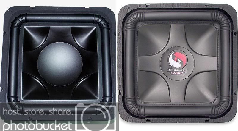

Give me some comment i just tested a subwoofer i am producing

here one photo which i put The sub and a kicker sub side by side .
While i am sure the kicker look better and nicer -
i would rather leave the comment open and if possible in futrue when you did hear the sound .
Choosing a Square sub is just part of the process of making subwoofer .
and to start off with q Square sub is also part of the fun - since i got the parts .
i got to admit that my spelling is not that good non is my knowldge of subwoofer .
but i am learning
I have no intention to sell this sub under the kicker brand
and like some had said . many brand also produce square subwoofer.
all comment welcome . as each comment will help me work together better product , be it design or understanding the market
Thanks you

Dude Im not trying to be an ***, cuz you seem like a nice guy (albeit a bit naive). And I realize English isn't your first language, but seriously, read this part till you understand it: nobody is saying the SQUARE SHAPE is your legal problem. Yes others produce SQUARE subs, but do they have the ribbed corner? No, they dont, unless Stillwater has allowed them too. You do not have to try to market this as a "Kicker" sub in order for that to still apply. Of course, in your country they may not care, but you wont be allowed to sell it here, not like that. Capice?
Lastly, none of the other square subs on the market are silly enough to try to be labeled as SQ drivers, imo you need to rethink your marketing or design strategy, they dont jive.
Good luck.

kicker sew the rip on the core - that is once fancy patent kicker own which suppose make the sound better . but alot of other good brand did not sew the rip onto the core - so is debatable
thanks for the comment and keep it coming

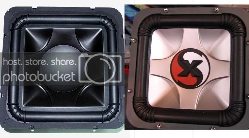

Its not a Kicker guys, look at the cheap/small ribs on the surround corners. The ribs on all the Kicker models look substantially beefier. It looks to me like a cheap third-world knockoff, or a cheap version built by someone else under label from Stillwater (probably the former).
i will look into the rip design as bring up by audioholic
- as i notice is a different design . and many years ago
by no mean is trying to debate if i am right or wrong here .
but just to point out that a patent is award to a design and if anyone can improve the design . or produce a different test result .
the patent is not violated -
many thanks to audioholic for bring it up and i will see what choices do i have to improve on the Rim design

So i would say i am sorry that it look cheap and third world
but this is the config which had been put together and tested at 500 wrms .
burned the sub at 900 wrms ( after 1 pus hour ) and would be safe to say a 1000 max watt
Here another photo using the Photo Jmanpc posted ( thanks you )
This one above might be a 10 inches - i am not sure so if anyone can provide more info would be great .
The above comparing photo i had i am not sure - might be a 10 inch kicker i just resize it to put it side by side for easy compare
