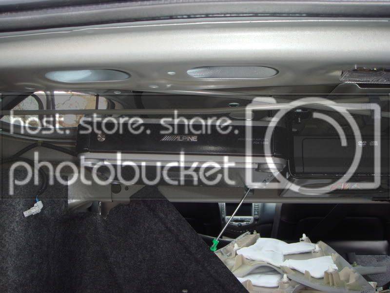

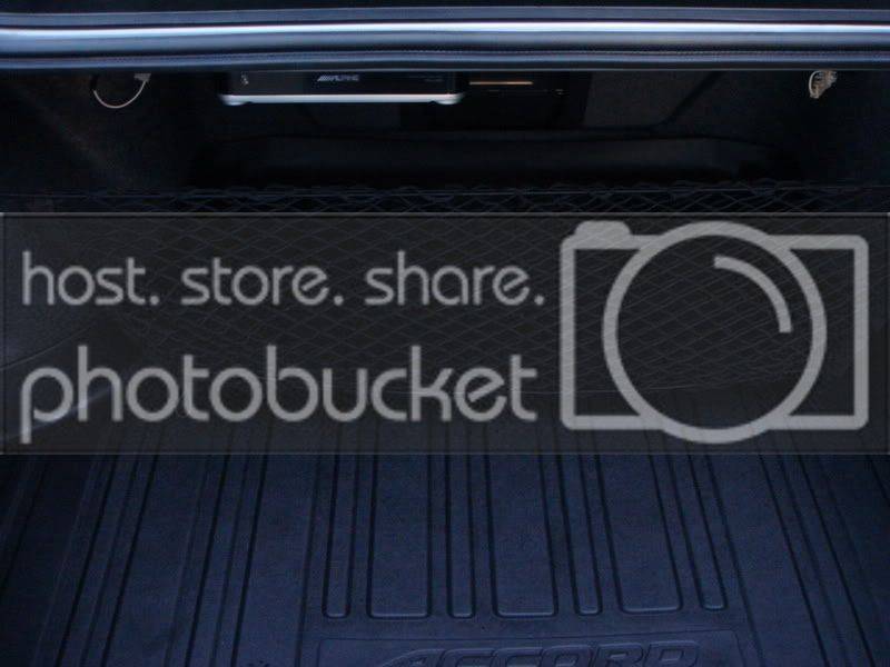

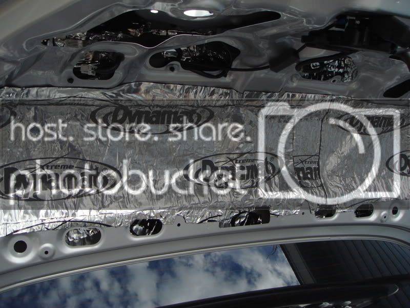

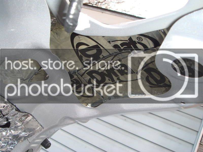

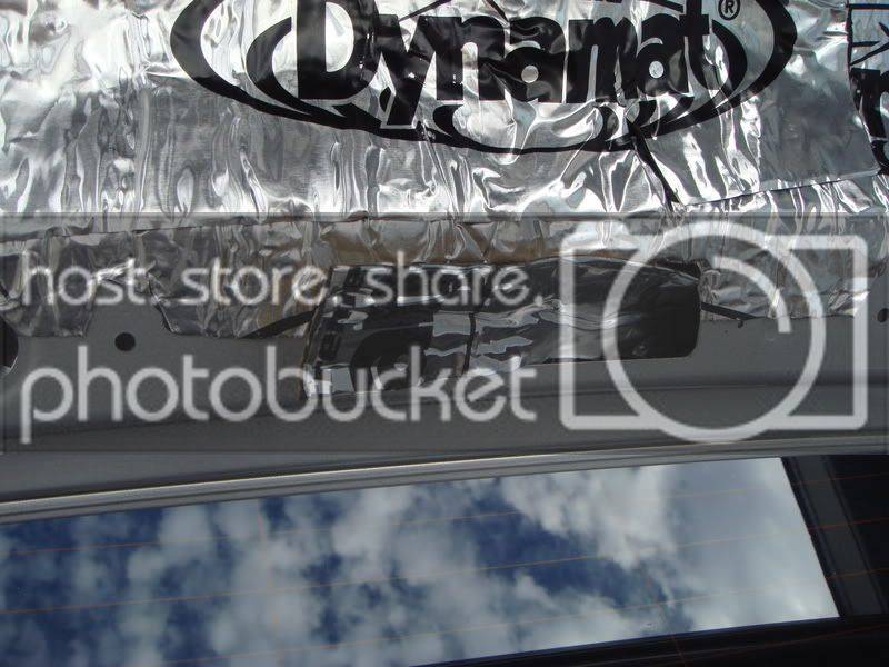

Finally finished sound deaden my trunk in my new 07 Accord(well about a month old now), weather was nice this weekend in the dfw area so I took advantage. Only took me 3 hours to do the lid, darn small openings. Took me around 6 hours to do the rest of the trunk. I used dynamat xtreme, yeah I know their are other options, but for some reason I like dynamat xtreme:crap:
On the 07 accord their is a carpet panel that covers the under side of the trunk lid, really nice. After I applied the dynamat you can't even tell it's there, just the way I like it. I like things simple and clean.
I temp wired my Boston G5 to see how it would sound, not bad, but I expected more. Maybe because I used a Zen mp3 player direct to a alpine pdx 1.600.//content.invisioncic.com/y282845/emoticons/biggrin.gif.d71a5d36fcbab170f2364c9f2e3946cb.gif Still have alot of usable trunk space, even my son fit:D Any ideas where to install 2 pdx amps? I tried under the seats, but there are alot of electronics and crap, no room, plus the darn ac vents are too wide:(

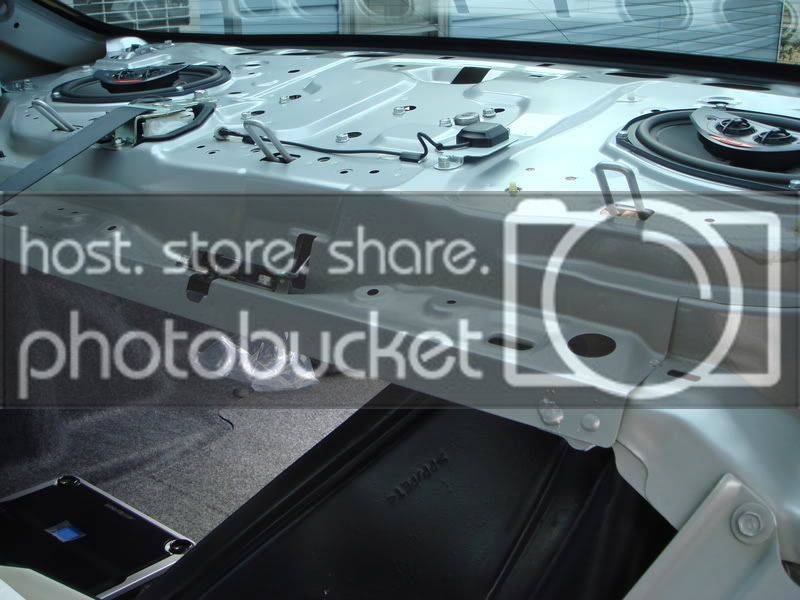

Installed the amps, overall I LIKED the way they came out. I also sound deaden the rear deck, I wanted to add closed cell foam also, but I forgot to order it:(

Taking the rear deck off, what a bunch of SH!T, I was swearing all afternoon:D

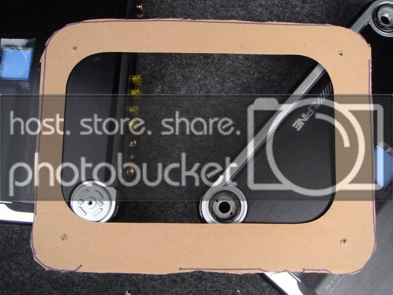

Simple cut-out for drilling the holes.
Had to cut around one rear speaker in order to put bolt through, Heavy Duty sheers made that simple.

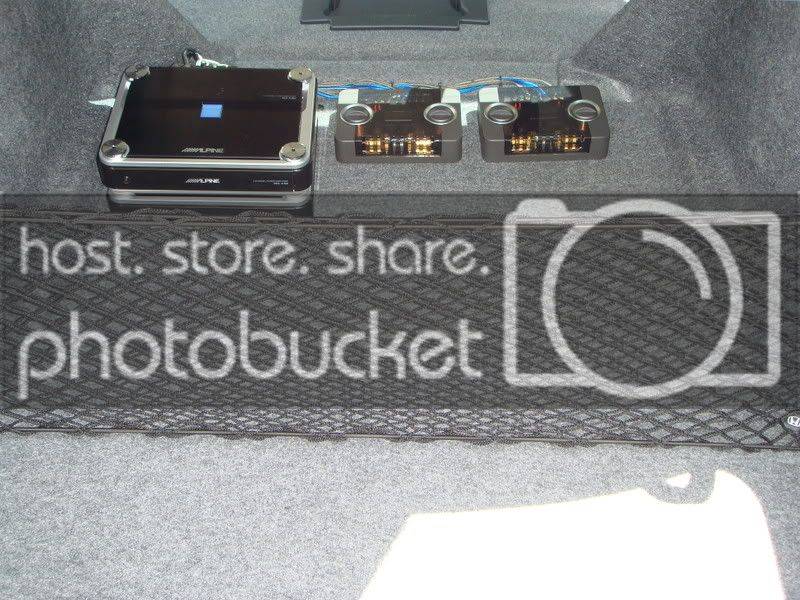

Test fitting the amps.

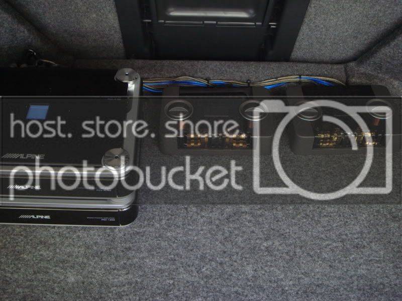

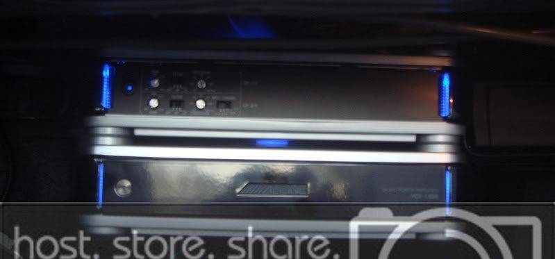

Finished, very secured, but I am also going to add an additional bracket later. There are TWO pdx amps stacked, you can really only see one, unless you look underneath.
Got some more work done....

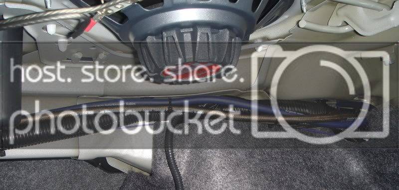

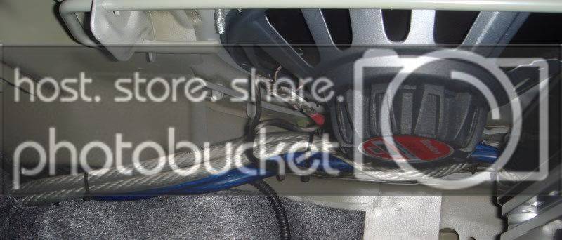

Got the amps fully wired
All wires are on top left and right side, pretty happy the way it came out.

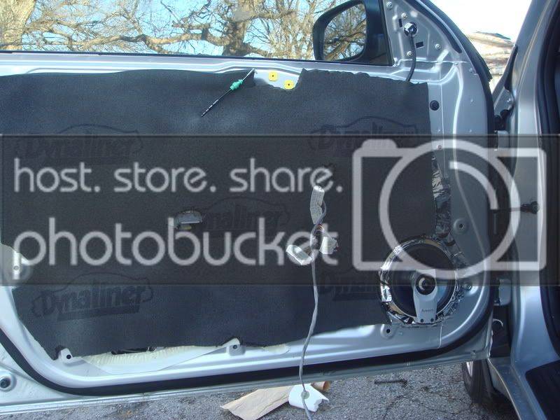

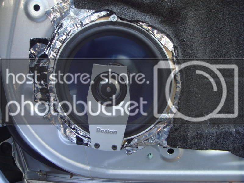

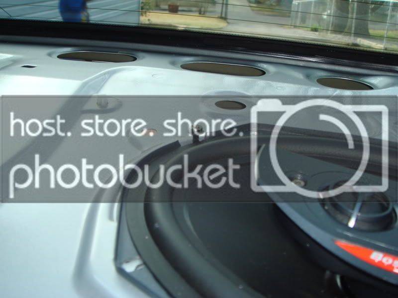

Got the Boston pro60s installed, cursing all afternoon, ran into a few problems. I couldn't run wire to the doors, the doors have harness that connect at the rubber grommet, what a pain, didn't feel like taking the door off to drill a hole. So I just used the factory wiring.

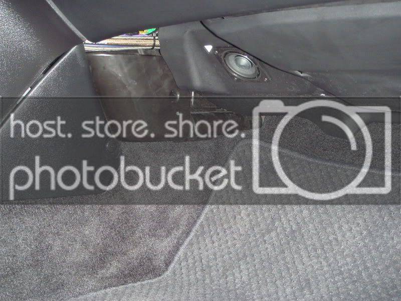

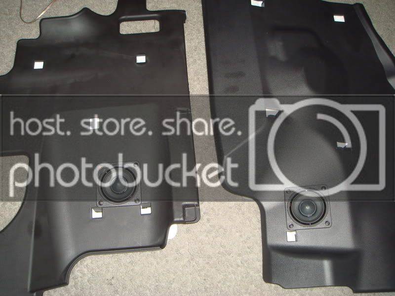

Installed two 2" tang band W2-852SF speakers in the panels that go under neat the dash, right above your legs. These are for the voice prompts on the factory navigation. These sound great and do the job well.

if it is a molex just drill a hole in an empty slot or 2 and pull the wire threw. other than that it looks good, just a lil worried about the amps and those thin bolts you used. i would have mounted them to the back of the trunk under a panel.
There was no room in the plug, believe me I was going to drill a hole in the plug. Yeah I am fabricating additional support for the amps, but just trying to finish everything up so I can have some decent sounds.

Boston Pro60's sound GREAT, even the SL95 sound good, yeah "ditch the rears" but I need them:) Without out the sub running, it sound good enough for daily driving.

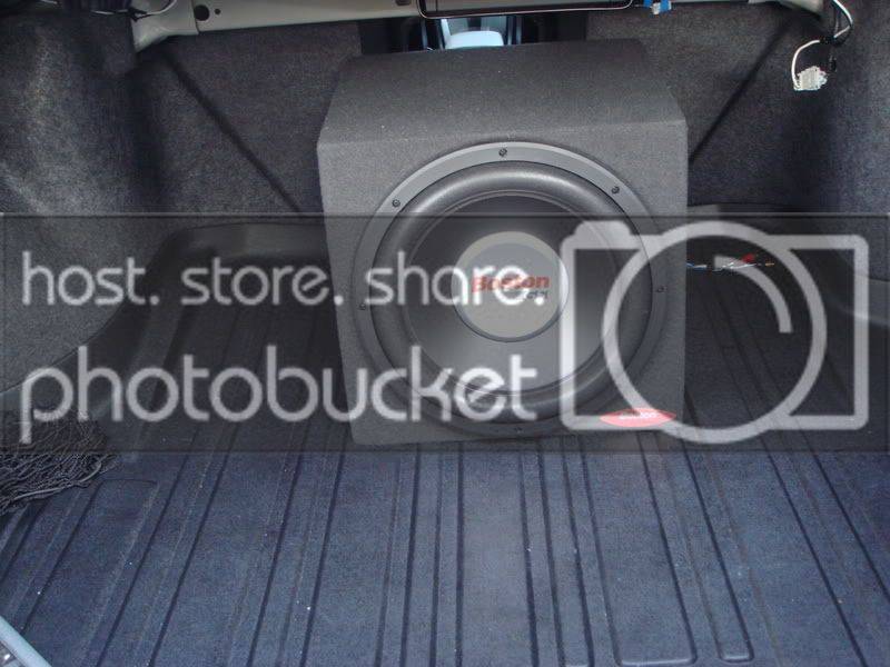

Boston G5 in Boston prefab box with GTR, tuned to 32hz. I have mixed emotions with this setup. First thing I noticed was, I couldn't get the sub to hit low notes at a decent level. I am not sure if because of the HU's lack of eq or the sub it self. Playing rap/hip-hop sounds fair at best, the lack of low notes is VERY noticeable. I am going to hookup my previous sub, a PG XENON 12 in a ported box tuned to specs, this box/sub combo hits lows like CRAZY. Will keep you updated.

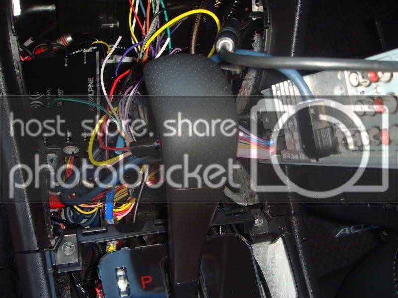

I couldn't get the voice prompts from the OEM navigation to work, the signal is obviously NOT coming out from the speaker outputs from the HU. There are several harness in back of the navigation unit, I am pretty sure I can tap into into for the signal. I would have spent more time with it, but my wife was nagging me to hurry up and finish this project up. So I will mess with it later, I am going to try and find the schematics of the harness online, all I know is the factory navigation is from Alpine.

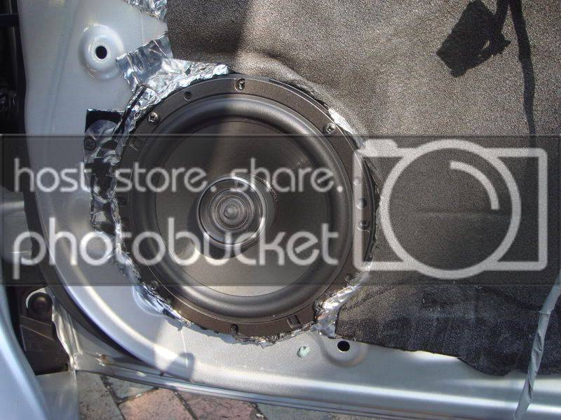

  • Switch Boston Pros to Polk SR6500

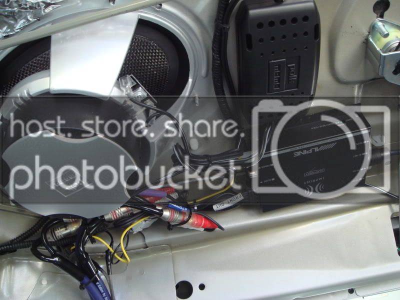

  • Relocated PDX amps
  • Ran another pair of wire for the fronts to rear, incase I want to go active:)
Had the processor in this cram of mess //content.invisioncic.com/y282845/emoticons/frown.gif.a3531fa0534503350665a1e957861287.gif
Moved under rear deck, once I get the tuning kit it will be much easier to access.

NEW Polk Audio SR6500:2thumbs:
Relocated amps here, only TEMP will have the amps custom mounted on the sub box once I decided on a sub:D
