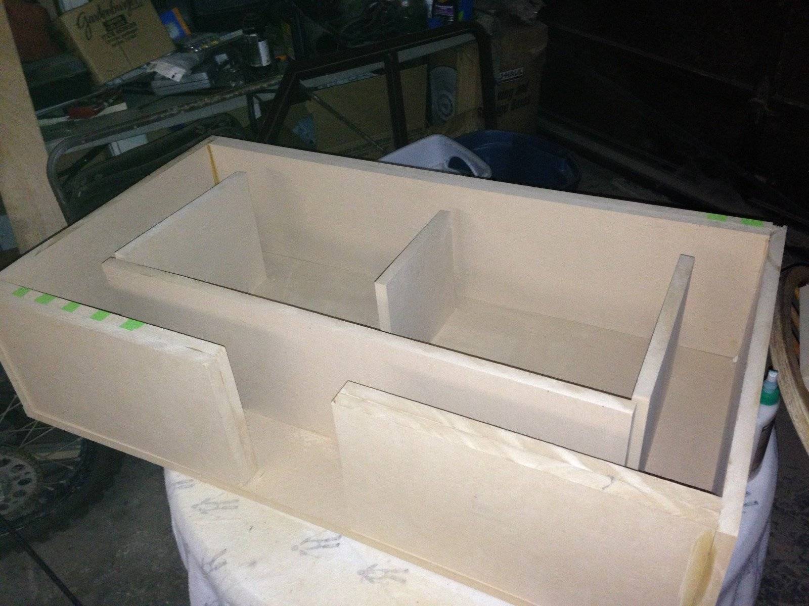

So its been slow sorry about that, been working on getting the box done, going to put the majority of it together after work today im hoping. Want to get everything installed this weekend. I'm tired of my fckin kickers. Anywho, this is what the box looks like so far
