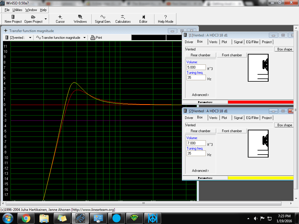

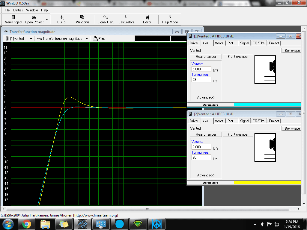

To show you what it actually looks like here's an hdc3 18 at 5 cubes vs 7 cubes at 35hz
With a lower tuning, you actually have a very flat response the the 18, output will not be anywhere near as good but if a person wanted an SQ oriented HDC3 18 box, that would be it.
