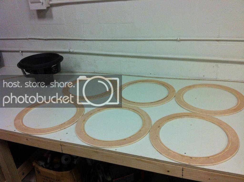

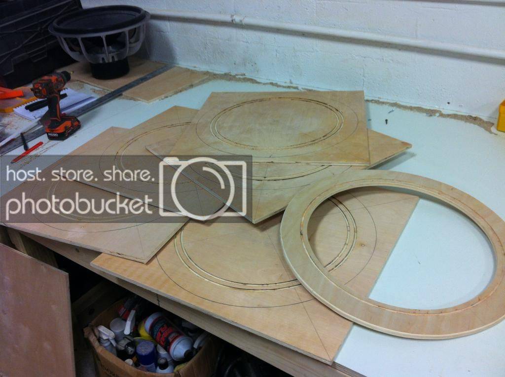

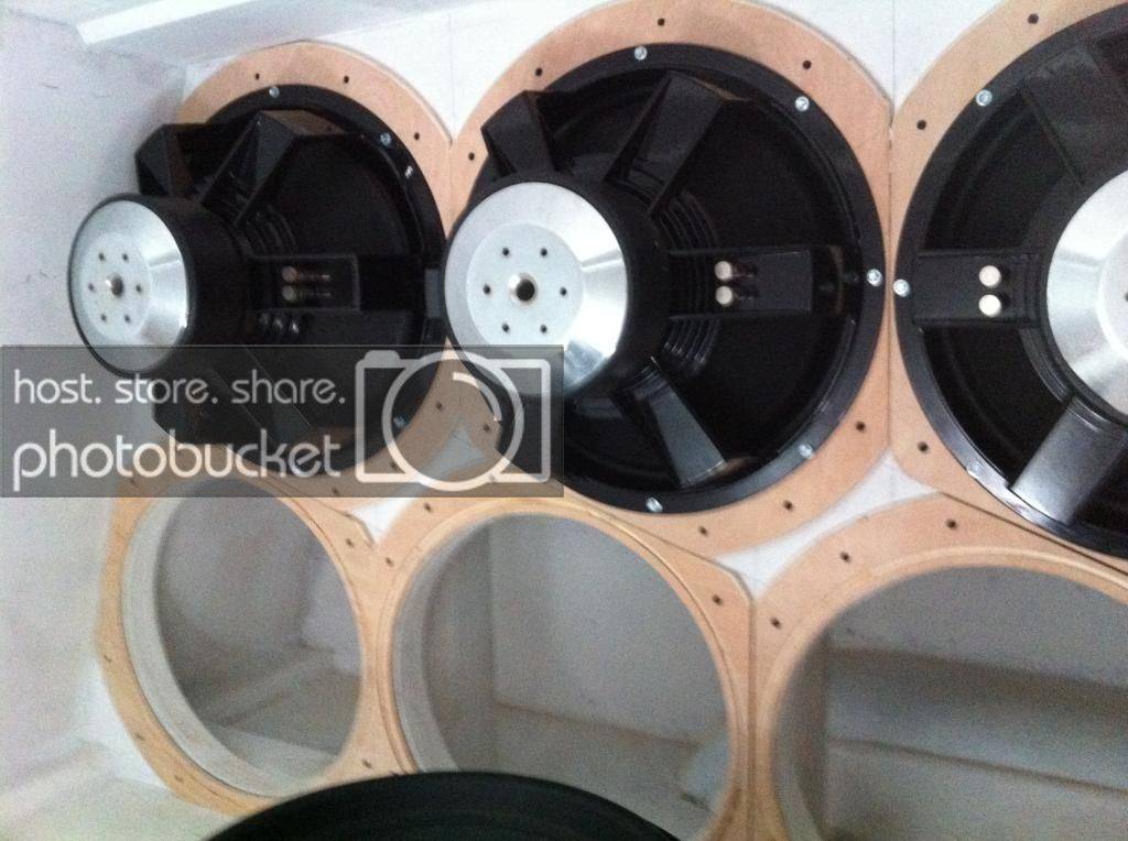

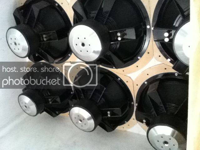

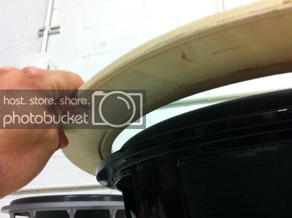

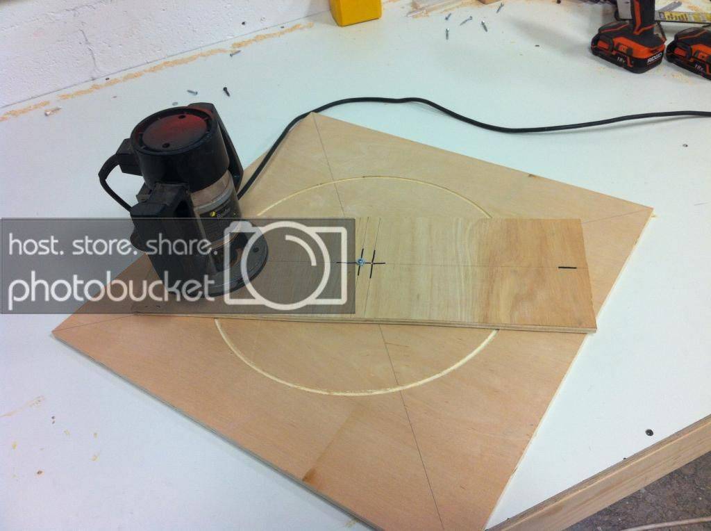

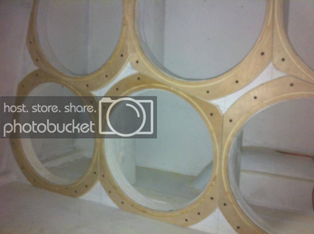

inverted mounting rings - allow the lip at the edege of the basket to perfectly sit in the router groove and be perfectly centered in the opening
why
because its so eazy to mount inverted on a vertical wall and have the sub move around and or mount with a piece of the rubber surround touching the cut out thats a no no big time. could cause coil rock and lead to a blown sub real quick

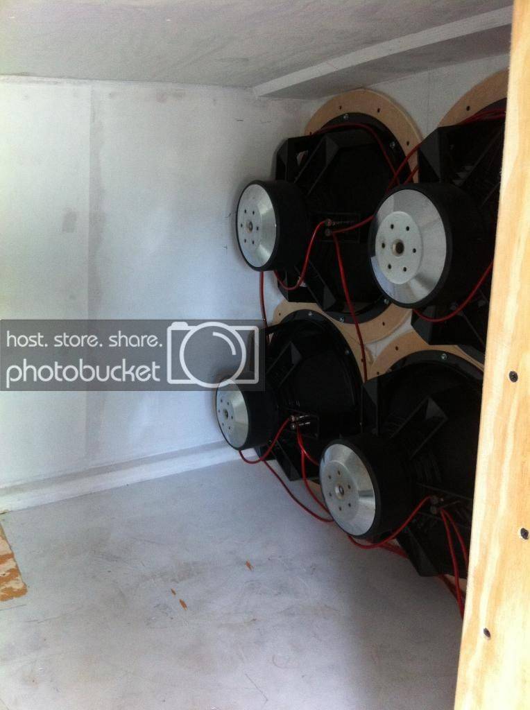

if i did better planning i could of made this look nicer but i just needed em in and they are all in now. ugh
building inside of an already built box is a re occuring theme in this build i cant shake it. keps happening and it *****.

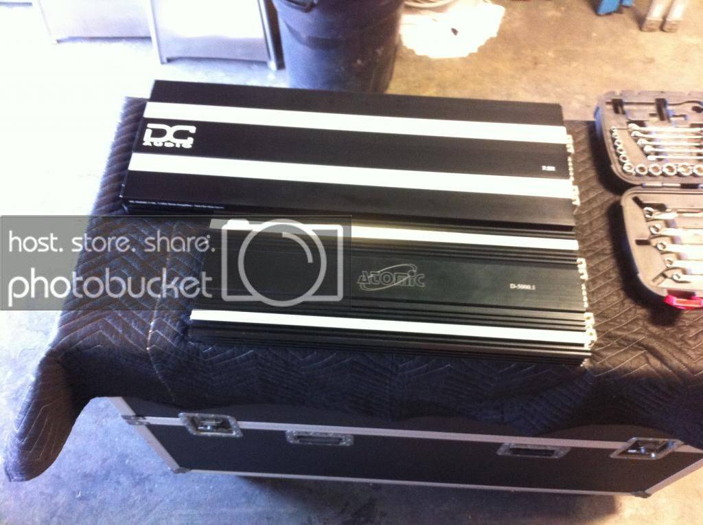

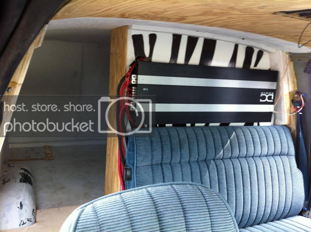

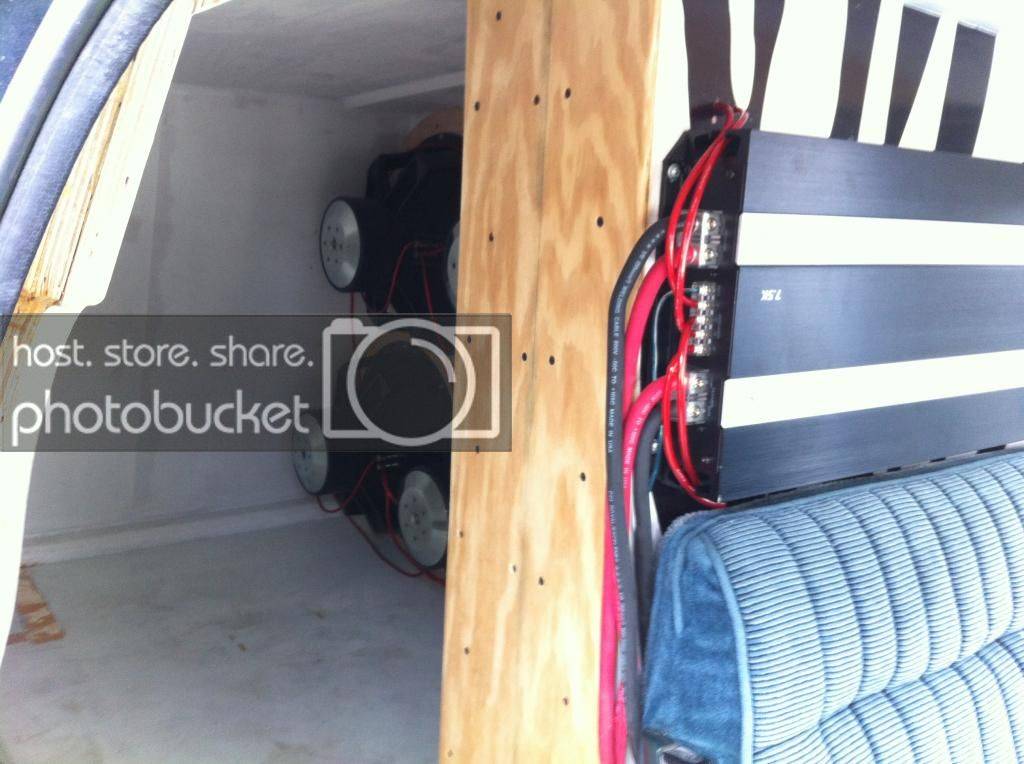

atomic 5k out
dc 7.5k in
literly no room leftover on my mounting area
ill get those wires zip tied apropriately later - lol i wana hear this thing.

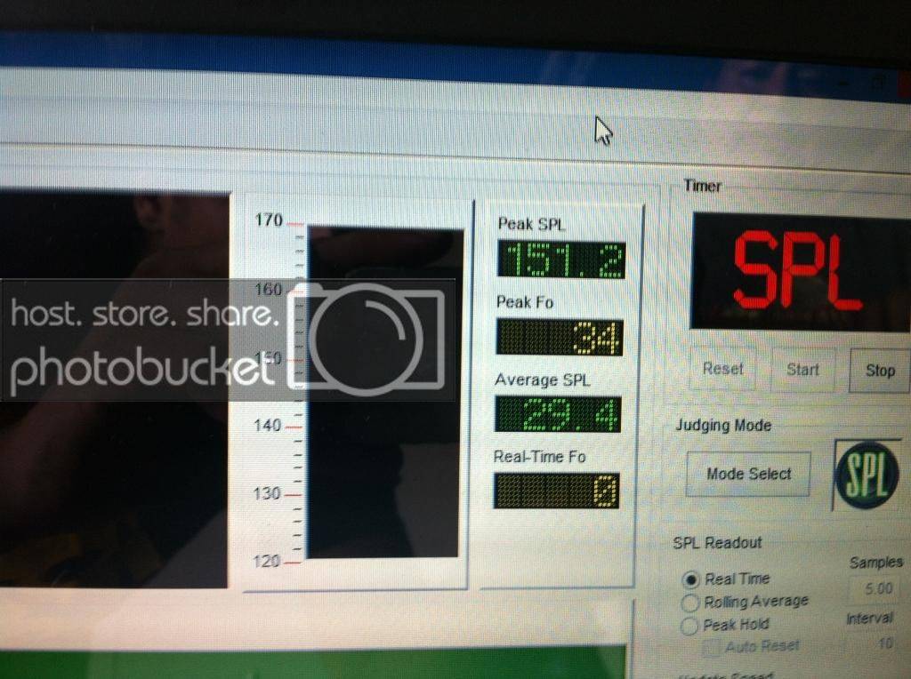

my last score was 151.2 at 34hz and was much more under control inside the cab at that score. id bet the farm im at least 2 or 3 or more db up the scale now and possibly lower hz peak.

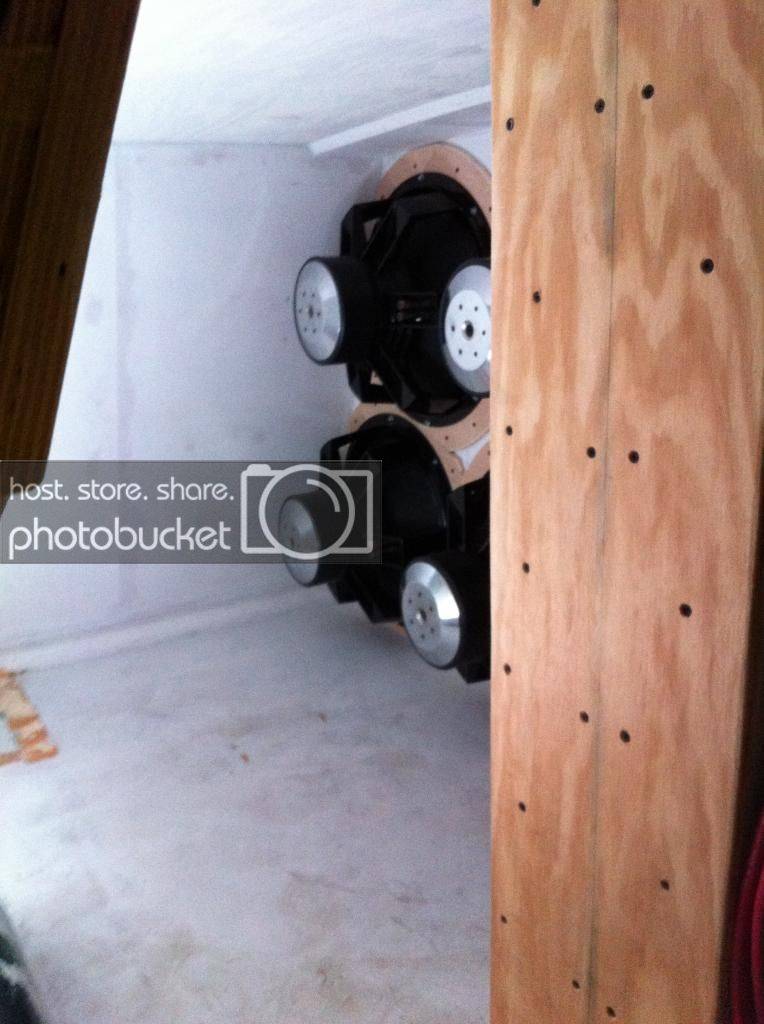

by inverting my subs - we gained airspace on the sealed side. between 1.6 and 2.0 cubes total more air space for all 6 subs to share so my best guess is each 18 now has 3 cubes each - maby a hair more 3.1 but probably not more than 3.25 each.
what should this have done ?
lower hz tuning on my sealed side
what did it actually do ?
well by switching sub and amp at the same time its realley a gamble to say this or that because of the 2 major changes at the same time but
there is more upper range bass now. before i felt it dropped off pretty much in the 60 ish hz range - and now it hits the 60s good / better than before
maby even still doing a lil work in the low 70s - the lows however are even further streingthened than before - i can tell because at 35 and under my truck is going bananas inside. used to have liquid steering wheel and mirrors - now the entire dashboard is liquid along with side mirrors actually folding them selves in to the truck - thats never happened before - and kinda ***** you need mirrors in a wall build. the floor of the burb is looking like a trampoline - and smokers refrence it was extremely hard to hold a lit cigarette between my 2 fingers the bass was just shaking so violently i was afraid i couldnt hold it and it would drop and burn something .... so yeah - dont smoke ok its bad for you.

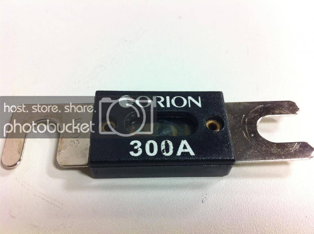

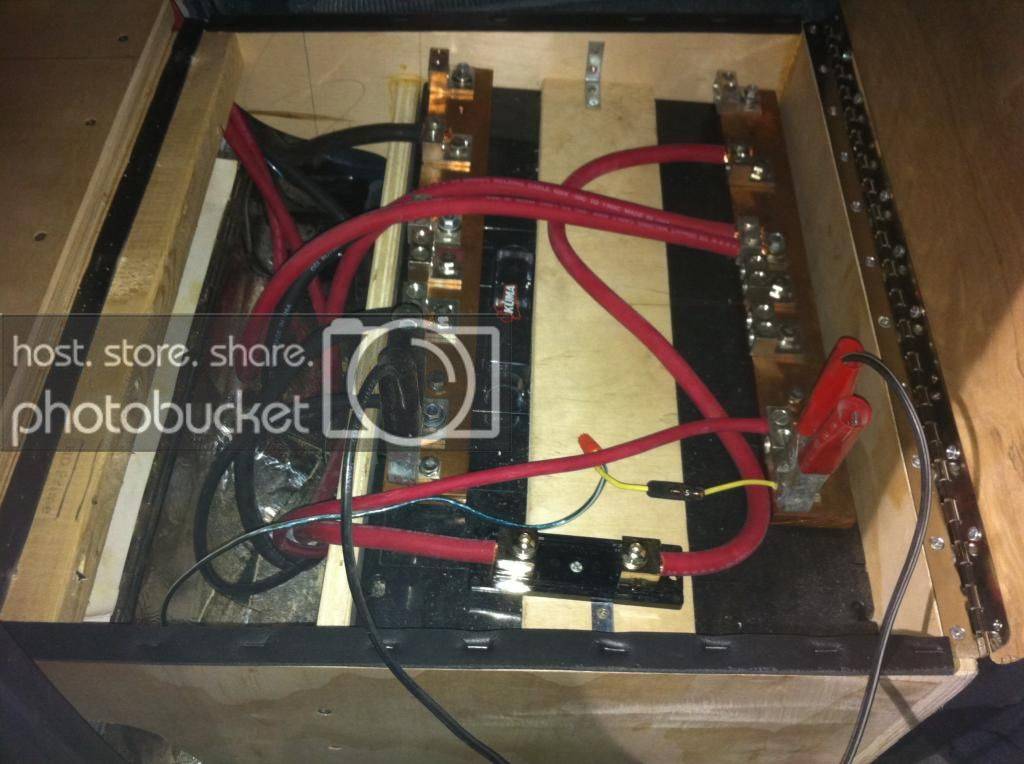

positive run from front battery to rear battery bank poped a 300 amp fuze at the rear fuze block.
amps sounded funny by the time i checked with dmm voltage was 12.5 at rear bank - and reading 15.1 up front still
lol
this is why you NEED a voltage guage hooked up to your rear bank. it makes no good if your front voltage is hooked to the guage and you have no idea your amp is in 12v terratory unless you have trained ears for this sort of thing its much safer to just wire in a dang voltage guage ok cool check thanks
