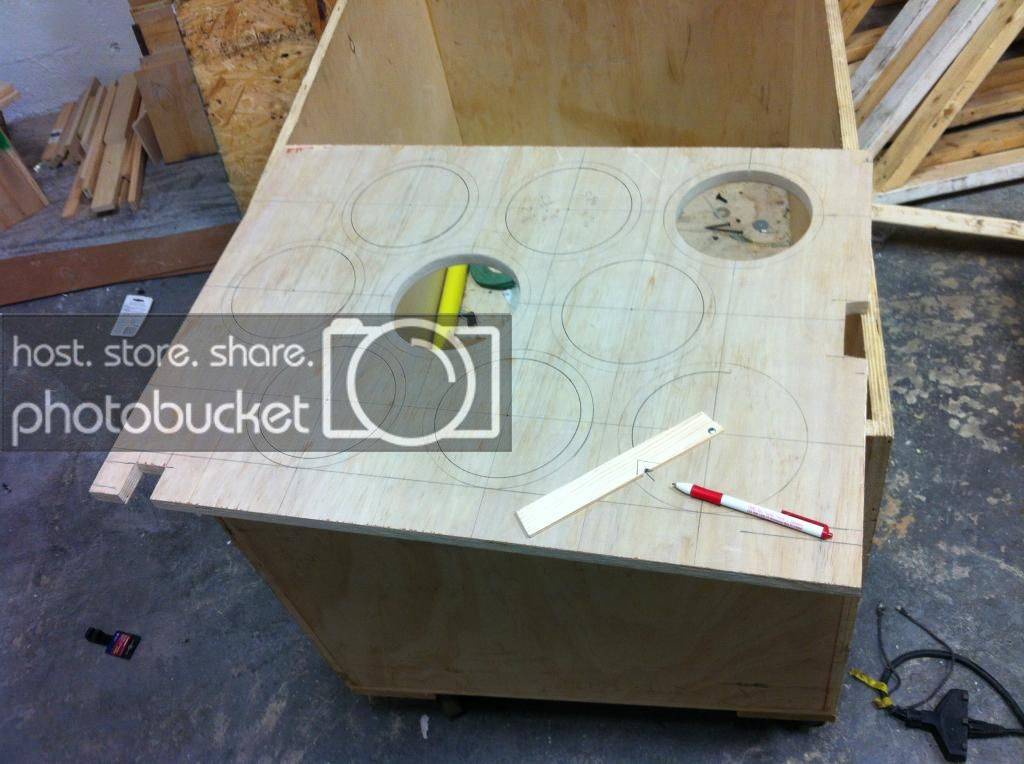

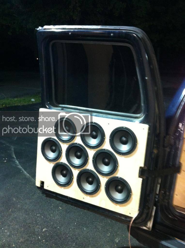

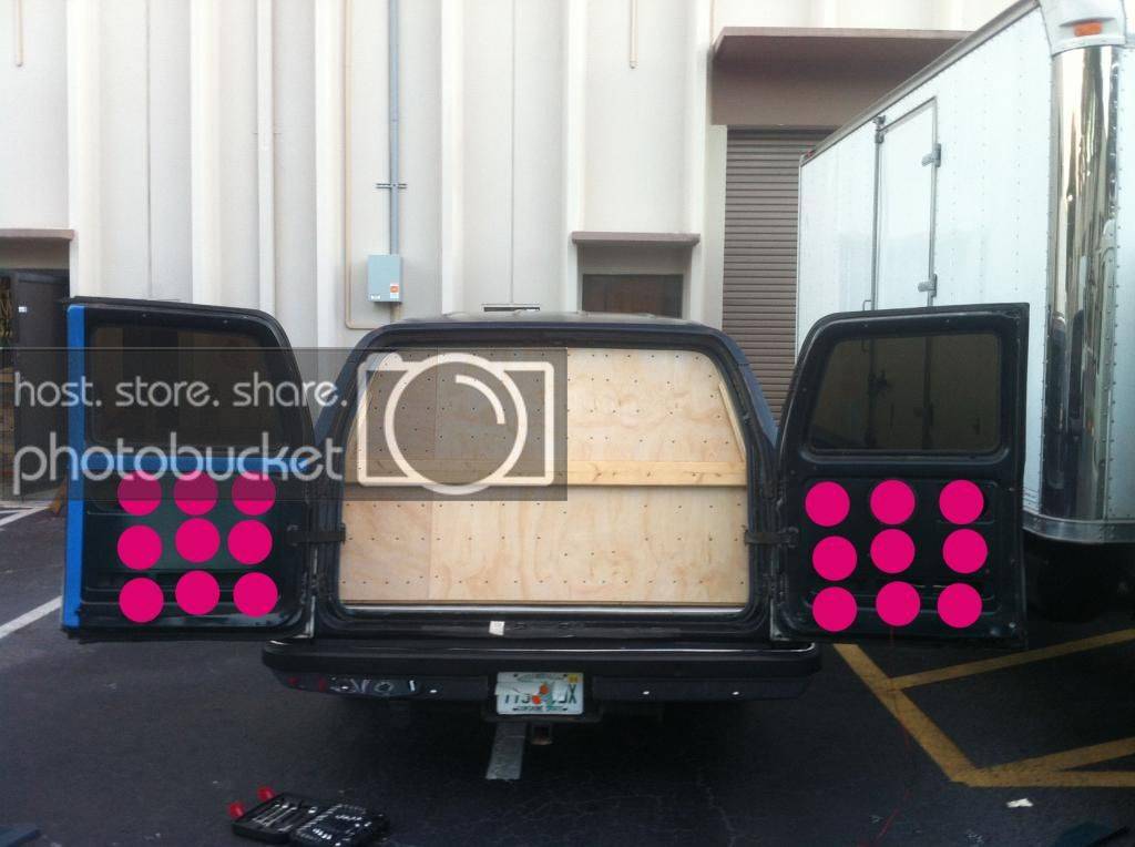

rough idea what my back doors may end up like ( placment of 9 6.5 each door ) but i have 26 of them lol i guess spares are a good idea haha $4 pe mid
eh im not the super biggest fan of bullet type tweets - might toss a few sealed back cone type 5" up in the window area if it needs them. the speakers i have for back there play in the upper range with authority still and have cut off of about 80hz where they break up pretty good below 50hz and sound like doo doo
we shall see how it goes....

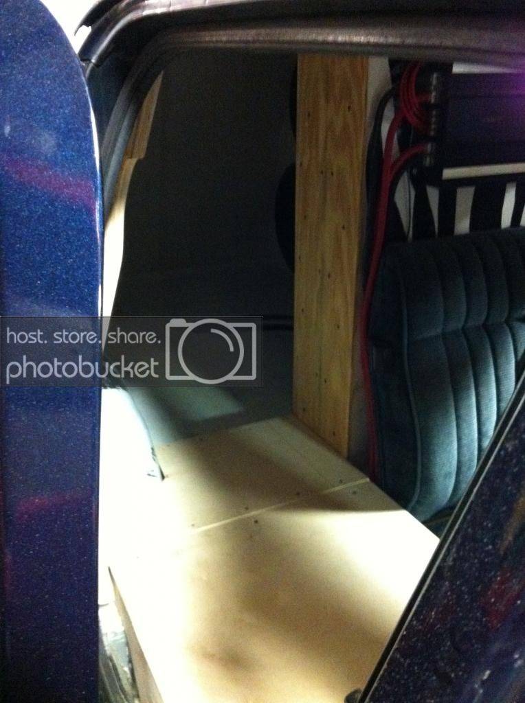

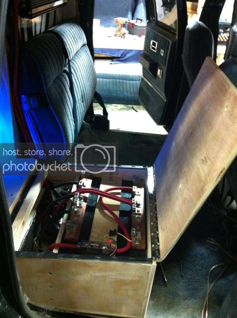

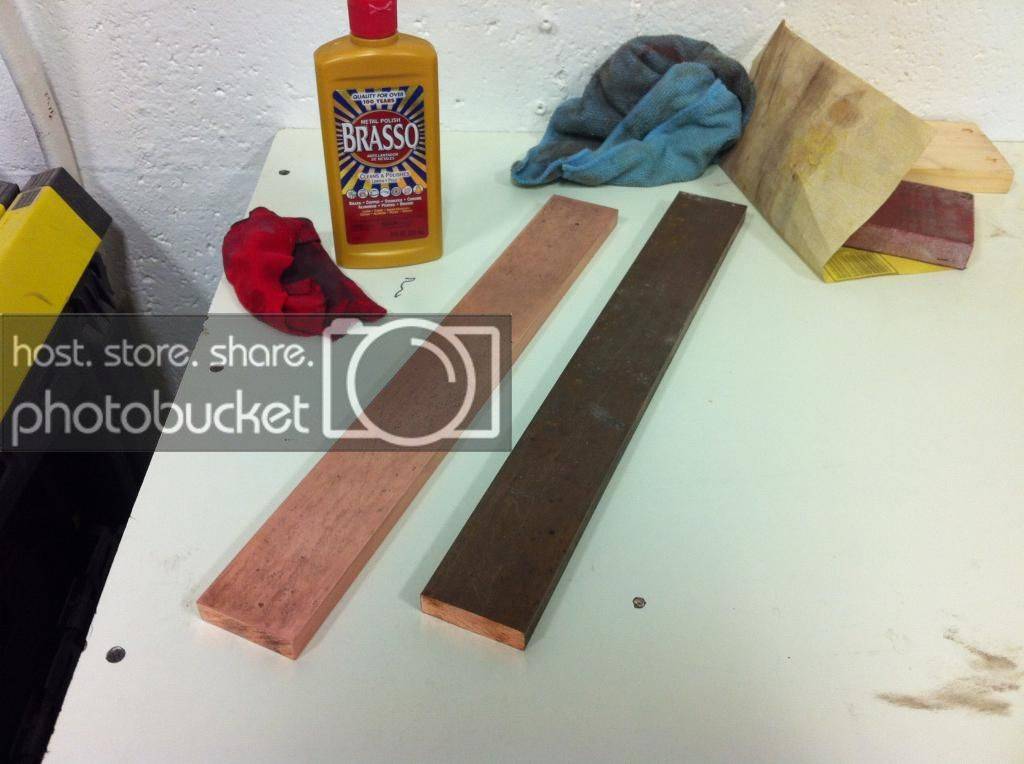

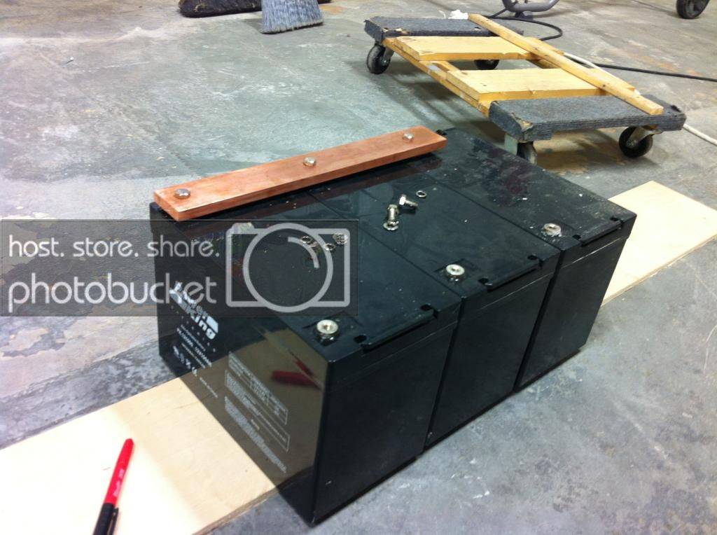

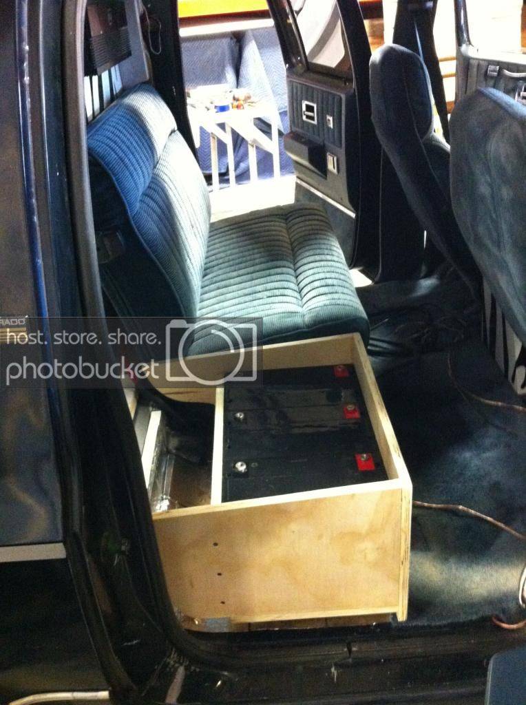

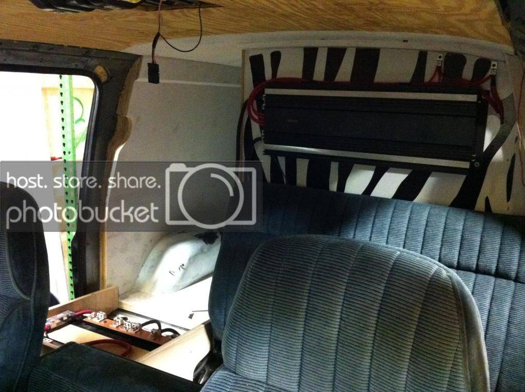

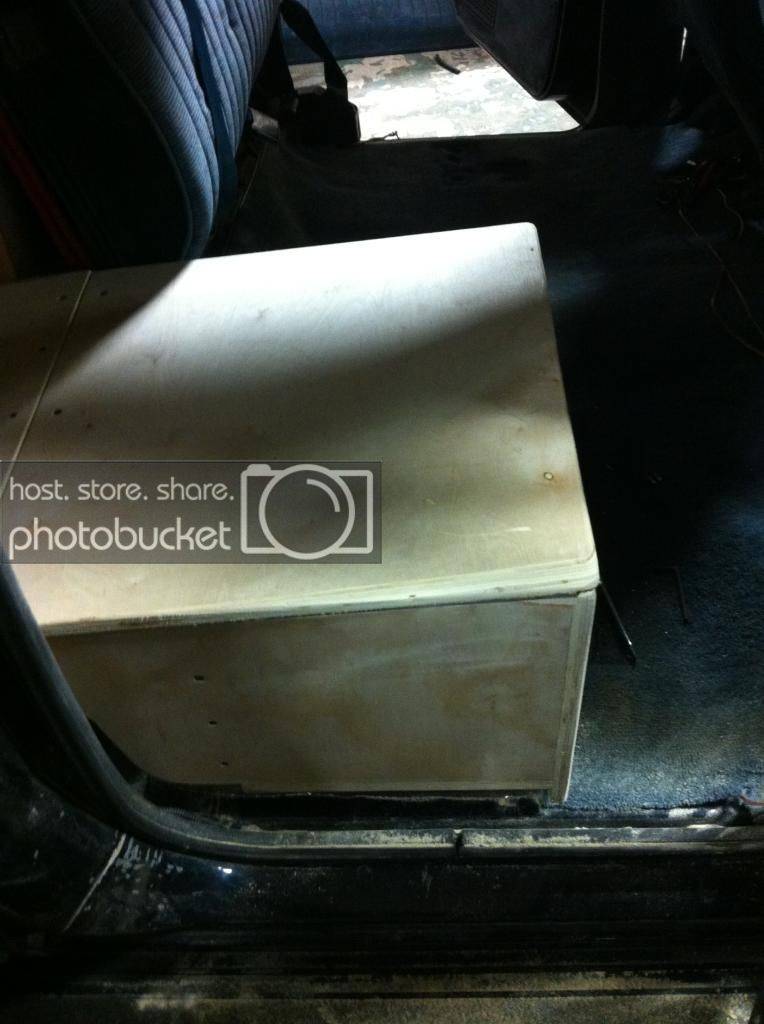

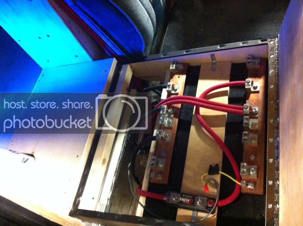

other random updates - COPPER bus bar has been aquired to re locate my batterys from inside the enclosure to under my demo rear seat - wich will be removed and build in to a wood shell of a seat to house all 3 of my reserve batterys - hooked with 16"x2"x.5" pure solid copper bar for negative and one for positive - and then have a pair 12" piece of same copper bar to attach to my loading wall face as a means of my wire junctions and fuze block hook ups...
will free up alot of 1/0 wire run inside the enclosure to allow me to double runs to my atomic 5k
so that can finaly go in

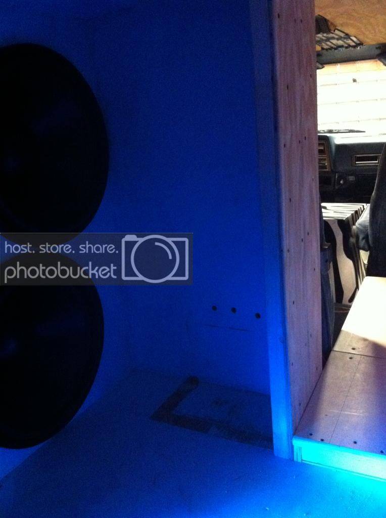

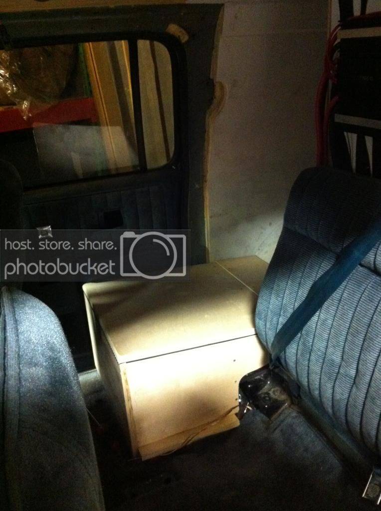

when i origonaly built my port it was the width of a 2x4 and a face of 3/4" plywood so thats about 4.25 inches - today i added a 2x6 to that port depth to create a longer port for a little lower tuning i hoped - now total depth is 10.5 inches
it plays nice - the 35 to 40 hz seems stronger now - and it has added some umph down to 27hz below that my output moves alot of air but not alot of sound....
maby next step is to shrink the port opening a 2x6 at a time and find the sweet spot

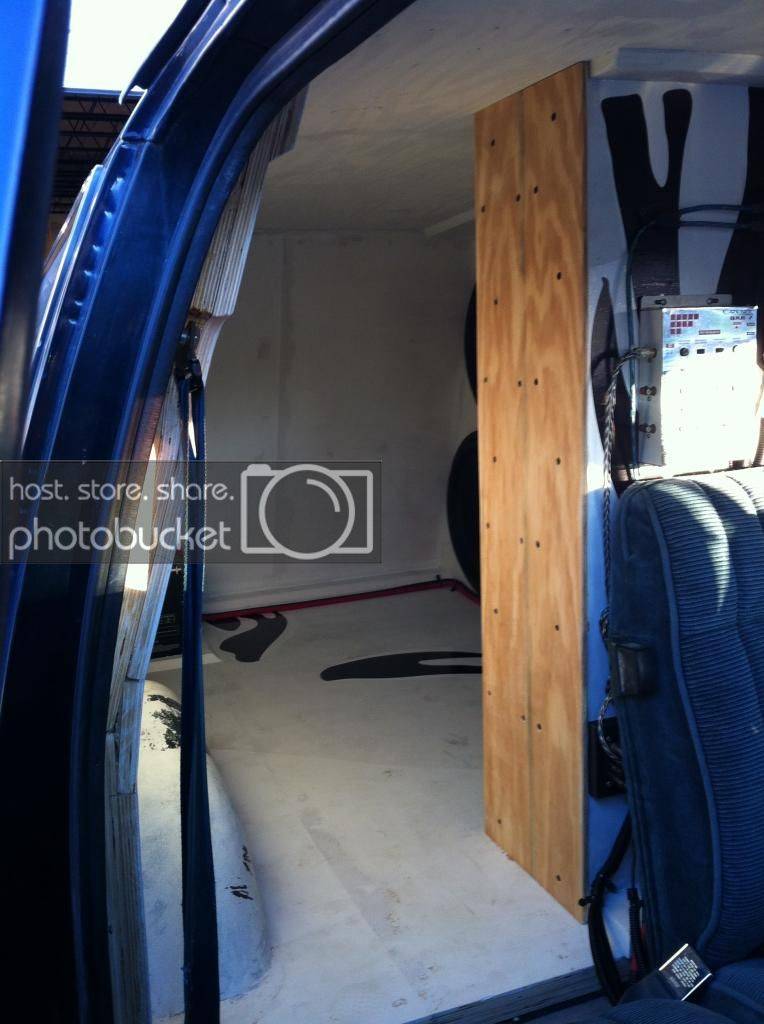

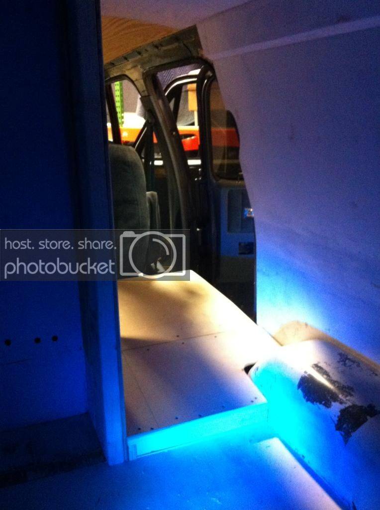

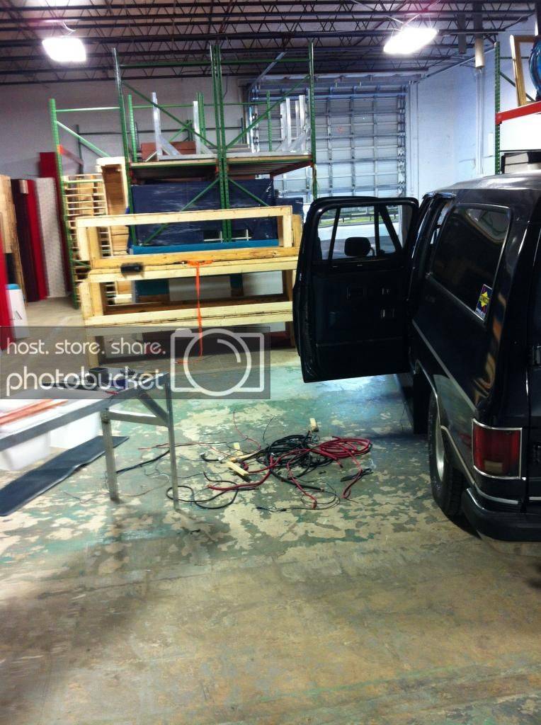

so since ive had some gear wating on me to fix some stuff in the burb to be more apropriate for the power levels running - i decided to gutt my wiring entirely also hoping to use pasanger side as power / and driver side as rca - as ive had some ground noise i want to get rid of
wiring get out
batterys get out of my ported section.
where do they go then ? in a fake seat made of wood - battery box demo port seat i guess
build

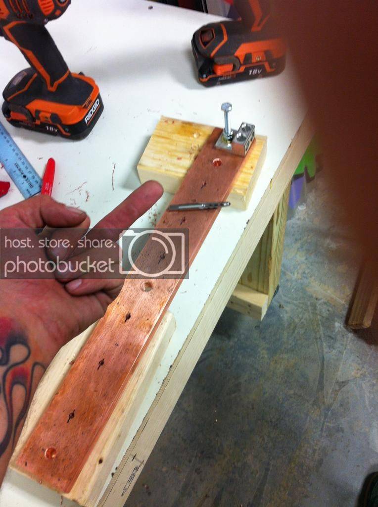

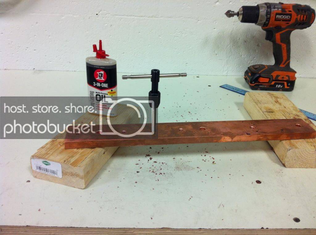

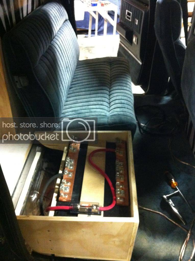

taping 1/4-20 threads on half inch by 2 inch copper bar is awfull - skip this step and pay someone to do it for you. money well spent
i did myself because the copper bar was DONATED FOR FREE to me by my local metal fab shop as it was in their scrap piles.
free is for me but drilling and hand taping the holes was awfull fyi.

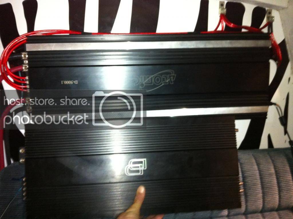

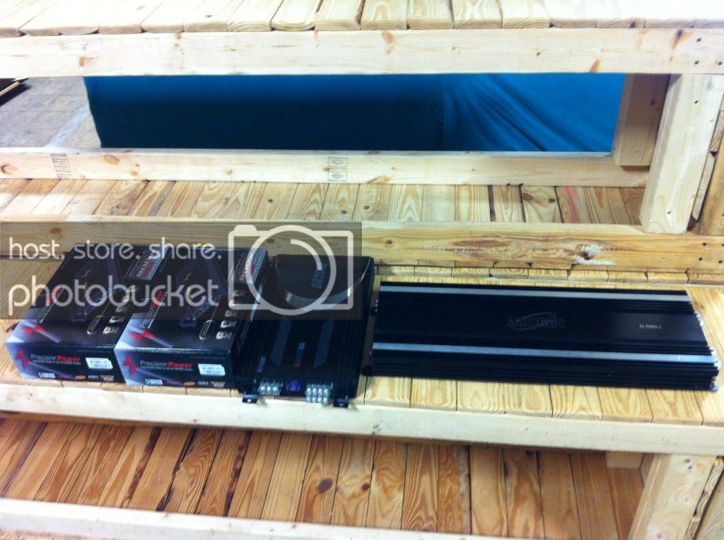

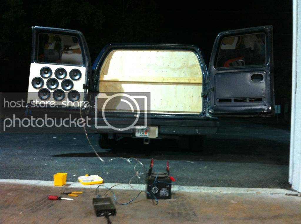

amps going in this time
atomic 5k replaces ddm3a
so sub amp is in and plays off rca to i pod chord to test with. no 4 chans in yet
its pretty violent inside seems to play 30s to 40s the hardest.

its not that bad to tap but log looks good
wiring get out
build
