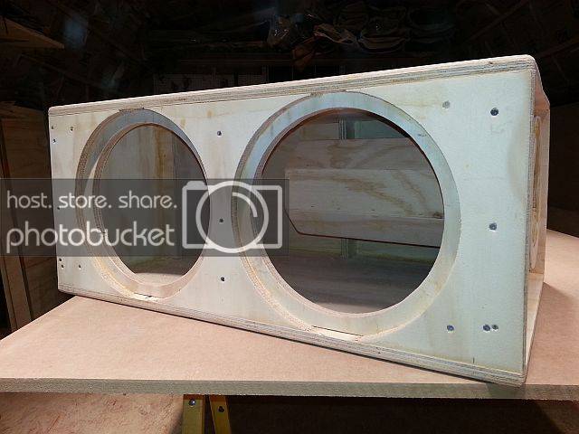

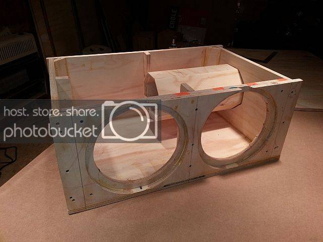

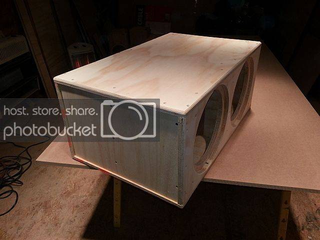

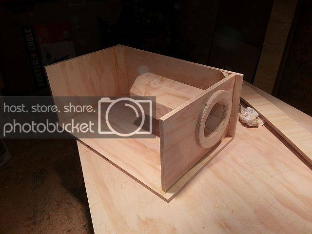

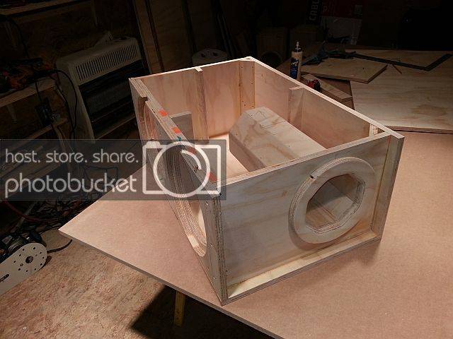

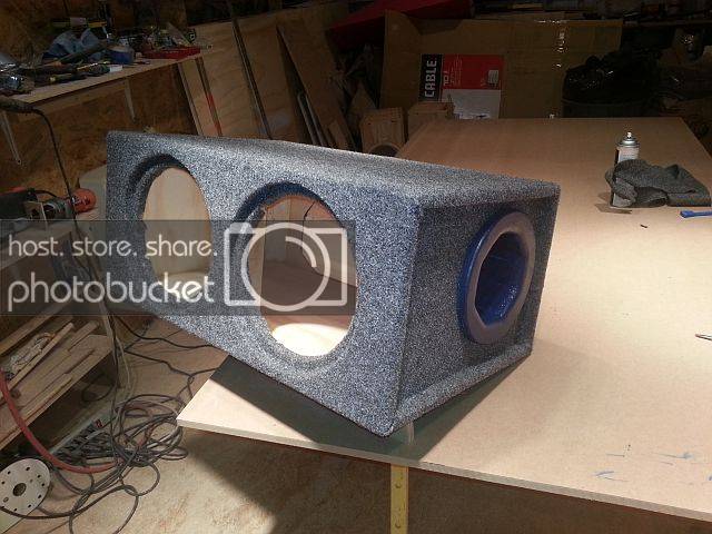

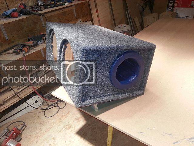

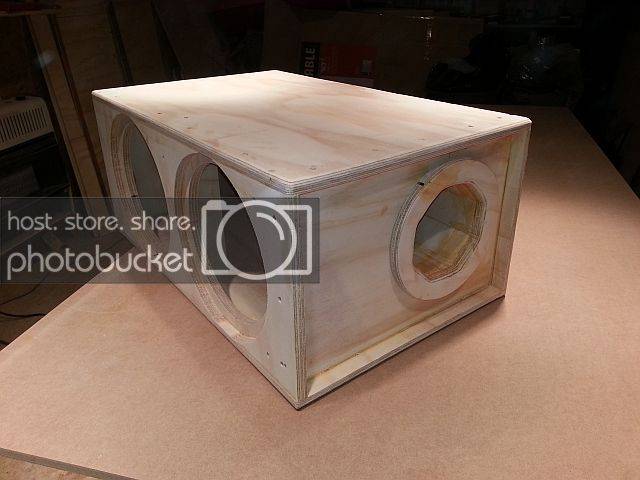

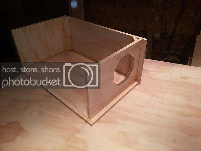

This is for two of his 12s......3.5cf net....35hz.....subs back/ Octo port to the side....Flush mounted front baffle
Wow lookw amazing!

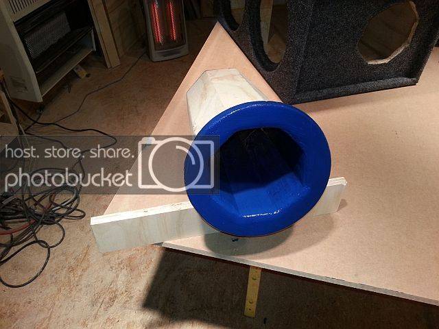

Thanks I have another coat of paint to put on the octo and then poly the crap out of it.....I test fitted a Havoc 12" I had here and it dropped right in.....It's a 12 spoke basket sub.....I will get her finished up tomorrow for Wed ship out
what wood is that and how would u rate it against mdf n birch
It's Arauco cabinet grade ply.....It's stronger and lighter than MDF and it's way better quality than the so called Birch veneer sold here at the lumber yards...I have used in it in tons of builds with out issue...My enclosure takes 5k daily and it's built with it......It's just a hit or miss product....Home Depot doesn't keep it 100% of the time...I wish they would though...It is great to work with....
