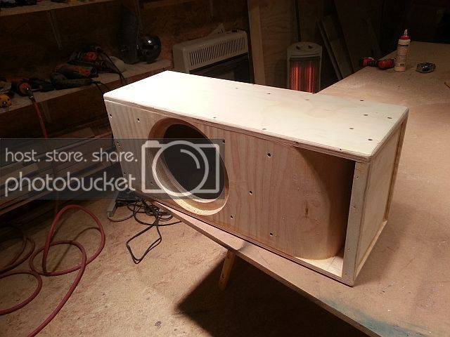

Ox10's FI SSD Enclosure....
double 07

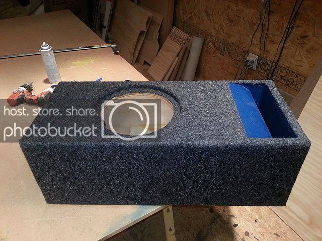

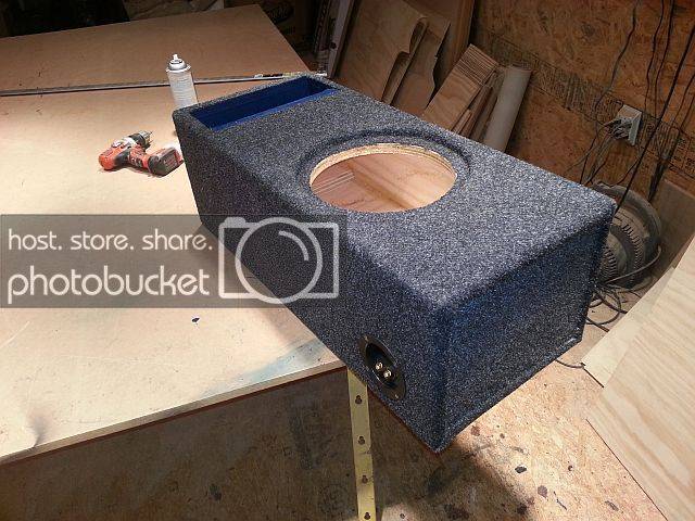

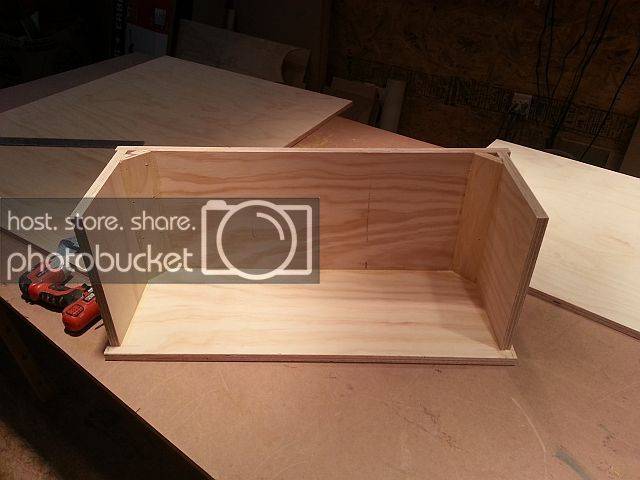

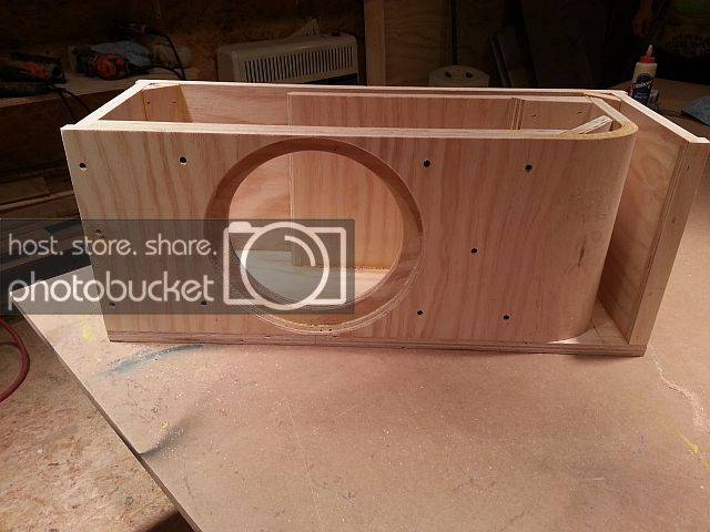

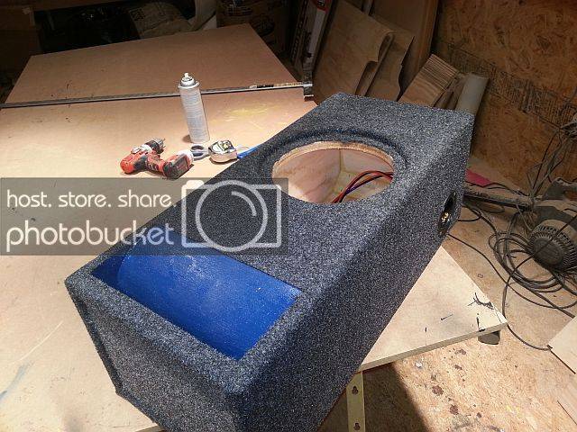

Single FI SSD 10"......1.2 cubes net....32hz....Arauco construction...kerf port.....flush mount...blue accents...
